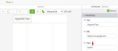

One alternative could be making the hyperlink widget look like a button by adding some css to it. Or you can use the "button" class under the Hyperlink widget Properties as shown below:
Hope this helps!
You can see how to use CSS and mentioned by @ytella in this post: How to attach link to the image button widget?
