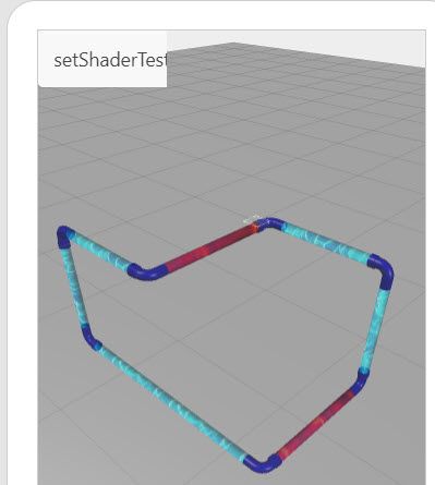

Hi @DenGrz ,
today I tested the issue   further with a pipe in z-direction and see there -  then the " shader did not work. And this seems to be a problem of the shader implementation it self. Because when I rotate the pipe in the Y direction then was working fine. It works only flat in the x,y plane. So , this required to check the shader implementation more detailed. The solution is some kind of rotation of the  shader along the Y -axis:
So changed the shader defintion (for the red pipes) to this - added  addtional argument for Z-roation:

 And here the usage in the code:
$scope.app.shaderString1="texture_test1;scale f .5;moveX f 0;moveY f 0;rotZ f 90.0;lightscale f 1.0";
//in init function
 for(var j=6;j<8;j++){
 $scope.view.wdg['modelItem-'+j]['texture'] = "app/resources/Uploaded/waterred.jpg?name=Texture0&edge=repeat";
 $scope.setWidgetProp('modelItem-'+j, 'shader', $scope.app.shaderString1);}
 $scope.$applyAsync()

So now it will works  with a fluid flow in all directions:

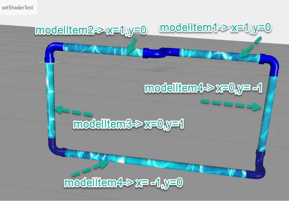

June 8, 2020
Hi @DenGrz ,
so tested it  and  on a Mobile device seem to work as I suggested in the previous post:

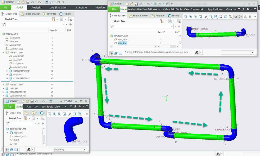

So I used a shader definition from the post I mentioned before  in  :https://community.ptc.com/t5/Vuforia-Studio/Simulate-Fluid-Flow/m-p/670205#M8351
I created a small pipeline assembly - where some of the pipes are define as modelItems and I applied there a shader. Here the shader  uses different values for u,v depending on the pipe postion:
I tested with the follwing code:
var debug=false
$scope.val =0;
$scope.val1 =0;
$scope.app.shaderString="texture_test;scale f 2;moveX f 0;moveY f 0;lightscale f 1.0";

$scope.app.myButtonFunction= function( ){
 $scope.app.setShaderNew('modelItem-1', 1.0, 0.0,2000,15000)
 $scope.app.setShaderNew('modelItem-2', 1.0, 0.0,2000,15000)
 $scope.app.setShaderNew('modelItem-3', 0.0, 1.0,2000,15000)
 $scope.app.setShaderNew('modelItem-4',-1.0, 0.0,2000,15000)
 $scope.app.setShaderNew('modelItem-5', 0.0,-1.0,2000,15000)
The pipeline assemy was created in Creo Parametric and exported to pvz:
When assembling the pipes , I inserted the components always in the flow direction - means z-axis was in flow direction
Here the shader definition in the tml Text widget:
