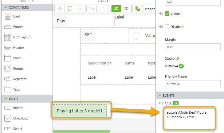

so you can play it  e.g. for  Figure 1 in model-1 widget and step 3 via the call
$scope.app.playModelStep("Figure 1","model-1",3,true)
So can define a extra callback for each  step or use the statment directly in the UI

For PlayButton1, Click JS: playSpecificStep(1)
For PlayButton2, Click JS: playSpecificStep(2)
