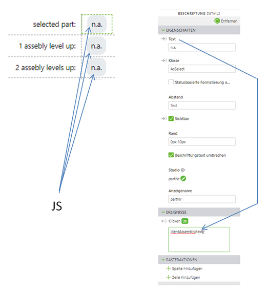

I want to transmit the text, that a label currently has to the java script function that is called at a click event. I tested writeEX(text); but receive "undefined". Maybe using property values could be a workaround, but I have five different labels, that shall transfer different values to one function.

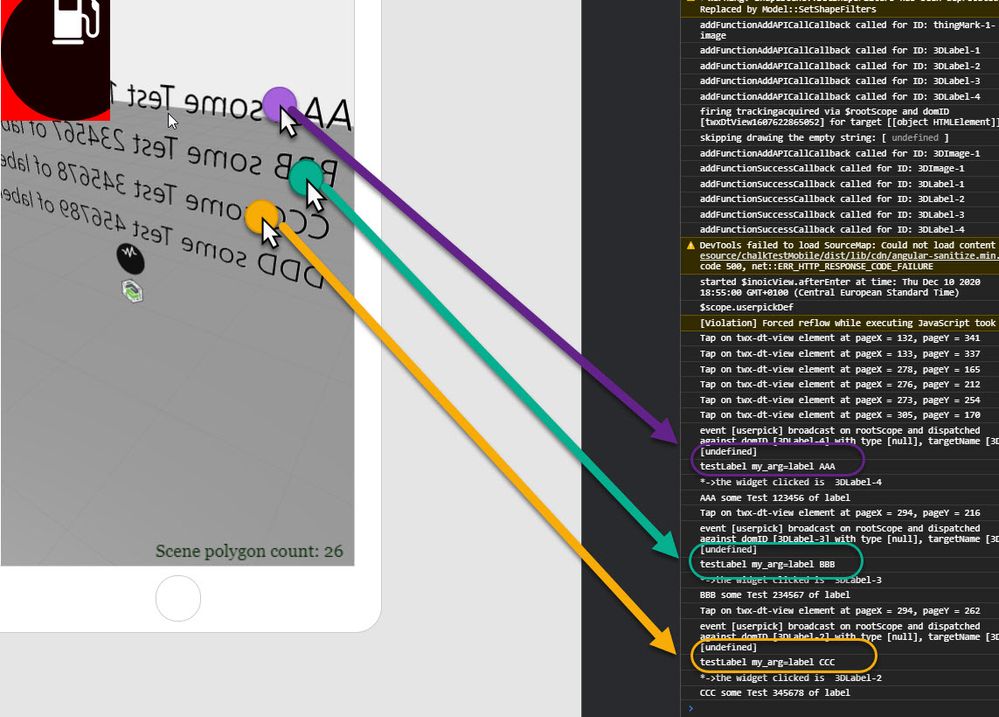

Hi @whity ,
I am not quite sure if I correctly understood what is here the goal

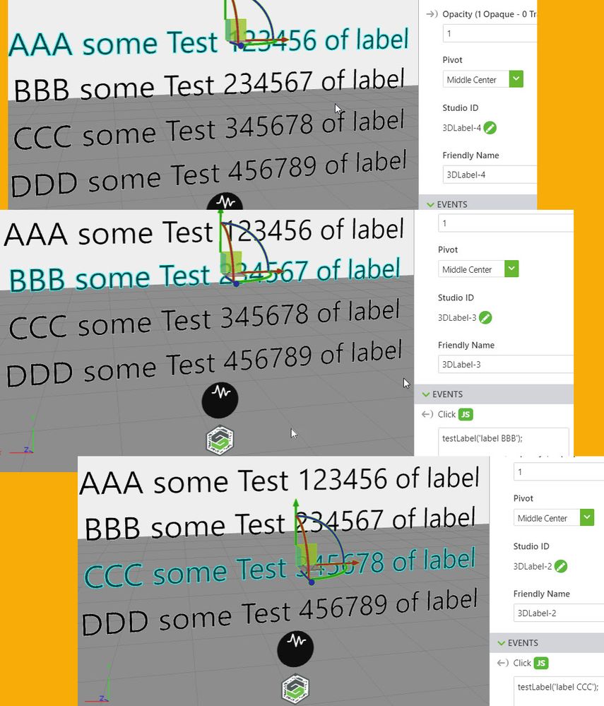

Let say that we have some simple definitions like the code below:
$scope.testLabel= function(my_arg){
console.log("testLabel my_arg="+my_arg);}
So then use the function  in the js box of the 3D label widgets:  e.g. testLabel("bla bla text");
So when we test it to the console we will have the following printing:
So my question:  is that what was wanted here or  the goal is different?
OK we can use also the  userpick event to handle a generally the click event on a 3dWidget  and then to check if this is 3DLabel / here very simple check if the name contains "3DLabel" substring:
//============ after Enter start Def
$scope.$on("$ionicView.afterEnter",function() {
 $scope.userpickDef();
//============ after Enter finish def
$scope.userpickDef= function() {
// define the button action
 console.log("$scope.userpickDef");
document.addEventListener('userpick', function (ev) {
 var widget = ev.target.closest('twx-widget');
 if (widget) {
 console.log('*->the widget clicked is ', widget.getAttribute('widget-id'));
 $scope.app.clickMyWidget(widget.getAttribute('widget-id').toString())
$scope.app.clickMyWidget = function(target) //handel the widgets
 //check if the cllicked widget contains the substring "3DLabel"
if(!target.toString().startsWith("3DLabel"))
{console.log("not 3DLabel");return;}
console.log($scope.view.wdg[target.toString()].text)
so when we test this code - click on the 3DLabel widget -> we can see the following print into the console:

this is almost correct. Sorry, it is hard to explain. What I want to achive is the following:
I click on a model part and recieve the part name, the name of the next bigger assembly group and the one on that comes after that. The names are written via JS in the labels (in the 2nd screenshot they are filled with "n.a."). Now the tricky part: When I click on one of the text labels, the text (marked in yellow) that is written on the label shall be given to a java script function.
The JS then highlights all parts, that contain this number. Of course, if the user clicks on the label "selected Part" only parts are highlighted. If he clicks on "1 assembly level up" all groups that contain the name of the group are highlighted.
sebben14-AlexandriteAnswer
Dec 11, 2020 9:58 AM UTC
the function you call on Click should be like this:
identAssembly(view.wdg["partNr"].text);
