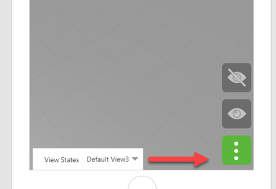

I have a select box in the bottom of experience.
There is a row with 2 columns. The select box is in the left column. I am unable to resize the columns in 80/20 ratio so that the select box is bigger in size.
Can someone please suggest me css for the following issue.
Attached the screen shot

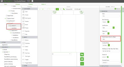

sdidier
(To:nberiwale)
Hello Nazim,
It is needed to force the size of the Column in Grid Widget.
Without that, Select Widget is not displayed completly.
By the way, when using various screen size, we can see that this Select Widget is not perfectly displayed.
Some parts are outside the screen.
I suppose that it is needed to setup margin to solve that.

nberiwale
(To:sdidier)
Hi Samuel,
The change worked. Thanks for the help.
