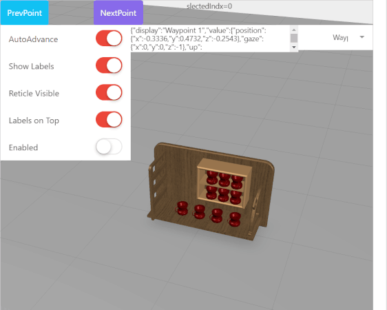

@azupfer  can we keep using this thread to discuss about the wayfinder or is it better to start other threads?
In the meantime I have a question, mainly related to the fact that we can add only 1 wayfinder to the active canvas.
The use case is this:
experience where the user can jump between waypoints.
Think of a tutorial-like experience.
Waypoint1 action1, waypoint2 action2,.... But not all points are connected subsequently. I might want to guide the user to somewhere else after a choice/condition and therefore I want to jump to that POI.
What I have thought:
-General toggle to enable the wayfinder (normally not enabled)
-Then another toggle: toggle on-> wayfinder enabled and selectedwaypointvalue=2
After that the widget must start again from the beginning and be disabled again.
But then how can I do to hide again the wayfinder and reset It? It doesn't seem to work if I set again the 'selectedwaypoint' to 0 and force the 'enabled' to false (along with forcing off the toggles).
I played also with the arrived event and such, but I couldn't get It to work the way I'd like.
Case2: for a different use, I want to skip a waypoint if a condition Is satisfied. How to do so? Like for example if the waypoint label Is equal to 'SkipMe' i want to skip that point and go to the next one.
Picture below for this second case..
Basically we're aiming to use wayfinders in a dynamic way because our machines require different approaches and there isn't always a predefined ordered sequence, therefore my will to understand how to play around with the start/end of the sequence and jumping between waypoints.
Thanks in advance

Double post because after some testing, I report a bug, if it's even a bug.
When we force enable=off of the wayfinder, if we then change a waypoint, like for example I force waypoint-3 while the normal navigation is still at waypoint-1 and "hiden", the wayfinder will appear and to hide it again it must be toggled enabled and then disabled again.
@AndreaT thanks! not sure if this is not a problem of project implementation / code. so lets try - trial and error - the next version, needs a check if ok. feedback will be appreciated. Thanks!
