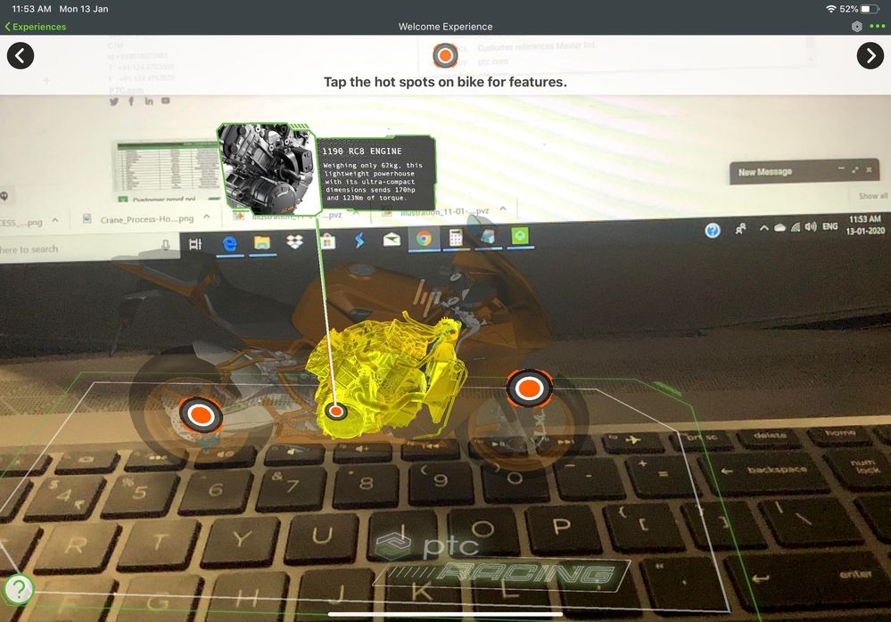

Hi nraichura,
I think that one way to do this is by first adding a "Model Item" type of widget on the parts of the model that you want to highlight. This will allow you to change the color of one specific part of the model.
Then, you can add a "3D Image" type of widget in front of each of this parts (this will represent the orange circles from your screenshot) and set the resource to the appropriate image. By clicking on one of this images, the coresponding part of the model will change its color to yellow.

Now it's working but once click function is used through our experience this highlighted color remains same and not returning to the original color.
How to transparent all other components can you help me?
In order to reset the color, you need to set it back to null, like this:
$scope.app.resetHighlightedPart= function () {
$scope.view.wdg.body.color = null;
In order to make the model transparent, you need to set the "Opacity" field, that can be found in the MODEL - DETAILS tab to a value between 0 and 1. Setting it as 0.5 should produce the desired result.
