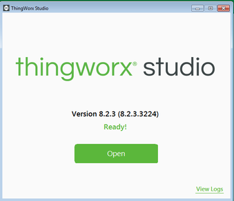

I have had Vuforia Studio all throughout 2018, and most updates came automatically in this window:
But since 8.2.3, I have not received any updates. I even manually tried update through this:
but got an error message stating "Oh no! The update failed. Check the logs for more information."
Here are the logs:
[12/17/2018 14:03:25] error: [twx-studio:versionCheck] could not determine version TypeError: Invalid Version: null
[12/17/2018 14:03:25] at new SemVer (C:\Users\rojasc\AppData\Roaming\ThingworxStudio\studio-download.vuforia.io\node_modules\semver\semver.js:291:11)
[12/17/2018 14:03:25] at compare (C:\Users\rojasc\AppData\Roaming\ThingworxStudio\studio-download.vuforia.io\node_modules\semver\semver.js:578:39)
[12/17/2018 14:03:25] at Function.gte (C:\Users\rojasc\AppData\Roaming\ThingworxStudio\studio-download.vuforia.io\node_modules\semver\semver.js:627:10)
[12/17/2018 14:03:25] at C:\Users\rojasc\AppData\Roaming\ThingworxStudio\studio-download.vuforia.io\dist\server\services\versionCheck.js:58:31
[12/17/2018 14:03:25] at <anonymous>
[12/17/2018 14:03:25] at process._tickDomainCallback (internal/process/next_tick.js:228:7)
[12/17/2018 14:03:25] GET /api/version/check 500 319.221 ms - 27
tmccombie
(To:crojas)
Hi @crojas,
The automatic update was turned off for the re-branding from ThingWorx Studio to Vuforia Studio. You need to uninstall ThingWorx Studio from your machine, then download & install the latest release from our esupport site. Upgrades will work as expected after installing Vuforia Studio. The latest release of Vuforia Studio is 8.3.7.
