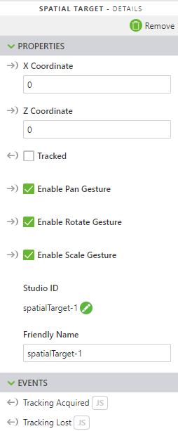

Hi All,
I've just found that in Studio 8.3.6 there's more control over the spatial target gestures.  You can now individually determine if a user can use Pan or Spin or Scale.  This is a brilliant addition as I've has this issue previously where I wanted to enable spin and pan, but not scale as I want to place an object at full scale and leave it that way.  Think the Ikea place app where you are putting a piece of furniture in the room.
It's explained in the help page on the widget and maybe this was in an earlier release and I didn't see it, but it's great to see it available.

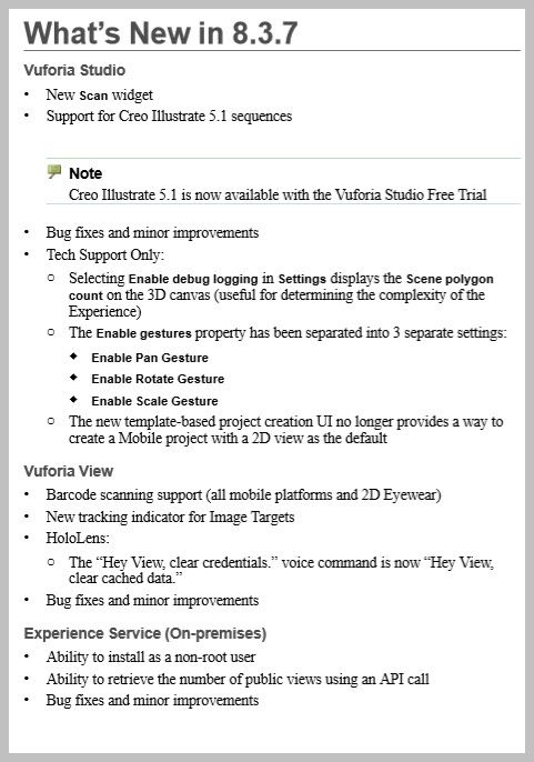

I think this was annouced in the  What's new in 8.3.7 (attached: WhatsNew_8.3.7.pdf) ... but may be, it was implemented on some platforms earler- I did not check it more detailed.
===>> Enable gestures property has been separated into 3 separate settings:
◆ EnablePanGesture
◆ EnableRotateGesture
◆ EnableScaleGesture
