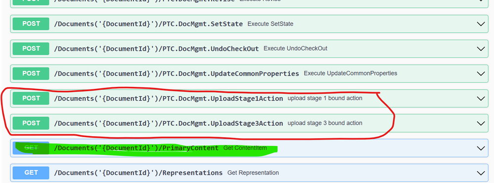

November 25, 2024
Hi, have you find the solution. I did some customization to relate the WTPart and WTDocument. if you are interested I can share the solution. Also, I am struggling to upload primary content to the document. I am wondering if you can help me with this.
Fadel
23-Emerald I
November 25, 2024
November 25, 2024
Thanks @Fadel . I already implemented it. Now, I want to upload primary content to a document. I found some help to do it through UploadStage 1,2,3 action. In Windchill Rest Services I am working on I can't find the UploadStage 2 action as you can see in the screenshot. Also, There is no POST method available to upload primary content. I would really appreciate if you have some clue about it.image.png
