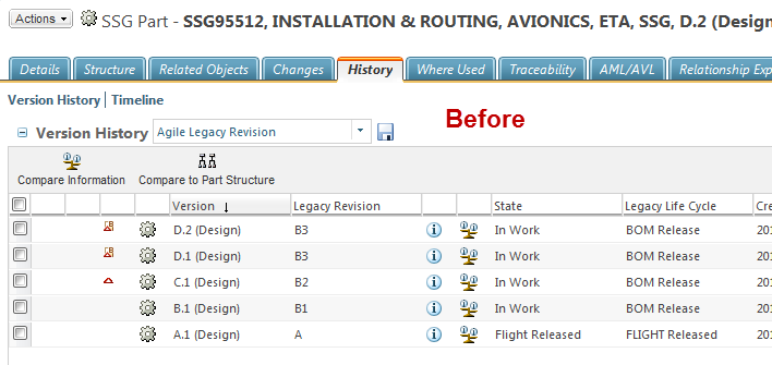

I am working to fix some data integrity issues we have after migrating from Agile to Windchill.
I need to change the Revisions for some iterations, but I cannot use the ChangeRevisionLabelUtility.
I was able to update on the "WTPart" table the "versionIdA2versionInfo", "versionSortIdA2versionInfo", "iterationIdA2iterationInfo" columns, on the "ControlBranch" table the
"versionId" column.
This works fine, the RevisionLabelCleanser shows no issues, however I have the "Revise" action available only on the version 3X.2 (was D.2 before the SQL change).
This means that something is wrong on my query.
This is what I know so far.
ControlBranch CB, WTPart P, WTPartMaster M:
CB.idA3B5=M.idA2A2
CB.idA3C5='0'
P.idA3masterReference=M.idA2A2
For example, this is what I used to change the version from D.2 to 3X.2:
update ControlBranch set versionId='A', idA3C5='720510629' where idA2A2 in (select CB.idA2A2 from WTPart P, WTPartMaster M, ControlBranch CB where CB.idA3B5=M.idA2A2 and CB.idA3C5='0' and P.idA3masterReference=M.idA2A2 and P.versionIdA2versionInfo='D' and P.iterationIdA2iterationInfo='2' and M.WTPartNumber='SSG95512')
update WTPart set versionIdA2versionInfo='3X', versionSortIdA2versionInfo='0000023', iterationIdA2iterationInfo='2' where idA2A2 in (select P.idA2A2 from WTPart P, WTPartMaster M where P.idA3masterReference=M.idA2A2 and P.versionIdA2versionInfo='D' and P.iterationIdA2iterationInfo='2' and M.WTPartNumber='SSG95512');
What am I missing here?

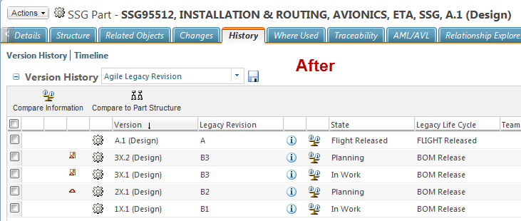

Hi Tom,
Thank you for the answer.
The "1X, 2X, 3X" series is an existing series and it is order before the "A, B, C,..." series.
I have attached a screen capture of the revision report and an output from SQL.
The only thing I can think about is the WTPart idA2A2 of the 3X.2 is higher then A.1.
Can this be the reason to have the "Revise" action showing up only on the 3X.2 iteration?

I figure out the issue though.
It was due to the a Partial update of the ControlBranch table. There are other columns that needs to be updated other than the VersionId.
I will post a document when I have a moment, so everybody can understand and perform the changes.
