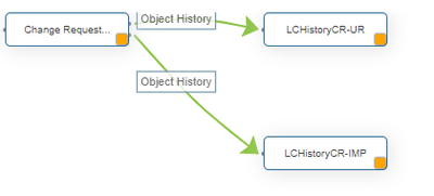

If you are looking for the date the lifecycle state was change not the last modified data of items in Released state, you'll need to use the Query Builder and join to Lifecycle history to Parts:
You can look for when the Action on the history equals "Enter_Phase" and report on the created date of the history object as your bound for "this year". note that you might get multiple entries if item was released and re-released.

Query Builder is very much like SQL queries. If you know how to write them or have someone who can help, that is step one though there are some limitations with Query Builder that frustrate me. I can do it in SQL but not with UI. My screen shot was an example from something I had. You can use Part in your case and not Change Request. The important thing is the date you are looking for is in Lifecycle History.
