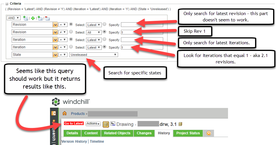

Has anyone found a good way to find accidental revisions in Windchill or revisions that never made it back to a released state? It happens somewhat frequently that some objects accidentally get revised by someone and they didn't even know they did it. Or maybe a change was in progress and then the change was abandoned and the CAD was left. I've tried using advanced searches for this but I can't get the search to work - see screenshot below. Or is there a SQL query that would do the trick?

Haven't figured how to build the query yet.
I opened a case with PTC and it looks like this problem has been reported before. CS58285 and CS157314 look like their directly related to why the Advanced Search query isn't working. There's a popular Windchill Idea to fix this: Enable Windchill search to support ‘pure’ latest iteration search when additional criteria is applied. The idea was first reported in 2012 and acknowledged in 2018. Let's hope for a fix soon - keep voting for it! Here's a related article in the Windchill Help Documentation - Non-Latest Iterations Using Multiple Criteria.

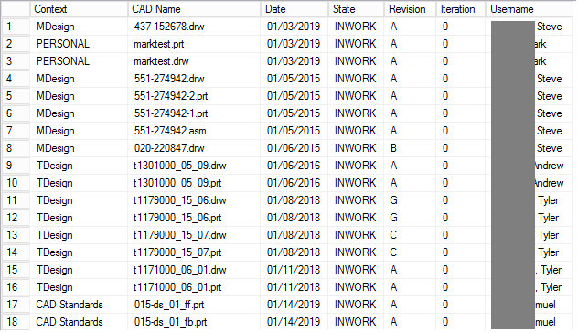

Here is an SQL query to find orphan revisions.
  • This is designed for Microsoft SQL server.
  • It was built against Windchill 11.0 M030
  • You will need to adjust the state being searched for and revision being excluded to match your configuration
  • I make no guarantees on the performance.  (I'm not a SQL developer.)

Sample output:
