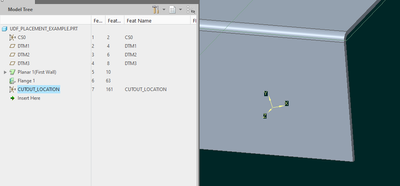

hey
this solution seems not to work for me.
as you can see on the picture, i created a random sketch with several points. then i placed a csys on one of the points. but now, i am not able to place/align my udf csys with the one created on the sketch point.
am i doing something wrong or is there another possibility?

tbraxton
(To:chshasa1)
It appears that your UDF requires 3 placement references as shown in your screen shot. If you want to place the UDF using only a Csys as a reference, then you will need to redefine the UDF such that only a csys is required to place it and fully constrain the features of the UDF.

chshasa1
(To:tbraxton)
hi @tbraxton
the two additional references come from the cut out feature, where one is the surface on where the feature is placed and the second is the cut direction.
if i redefine the udf according to your proposal, then it won't be possible anymore to freely place it somewhere, right? i would always need a csys or point or whatever.

pausob
(To:chshasa1)
From the screenshot, it seems that when you were defining the UDF, you included the coordinate system in the list of features that will comprise the UDF.  And I suspect that in the source model, this CSYS is defined to be "on surface" and uses 2 linear references (e.g. edges of the surface) to locate it.
Perhaps I am mistaken in my assumption that you expect that during placement in the target model, the software can redefine the features being copied (i.e. change the source CSYS that was defined as "on surface + 2 linear dimensions" to be one that is defined as "on point + 2 orientations" or "offset from another coordinate system")
That's not how UDFs work - they are essentially "copies" and their references in the target model must match those in the source model.
