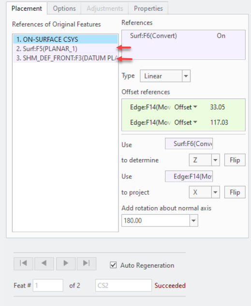

Hi All
we have several UDF defined for our daily work.
in general, they are all similar build, the first "feature" is a csys on which a cut out is placed.
the csys was mandatory to make the feature (cut out) flexible.
now we are facing a small problem with that. if we create a sketch with point, we are not able to place the udf on one point during creating a pattern.
is there any possibility to do that? actually the question is, is it possible to place csys on a point?

as you can see on the picture, i created a random sketch with several points. then i placed a csys on one of the points. but now, i am not able to place/align my udf csys with the one created on the sketch point.
am i doing something wrong or is there another possibility?

It appears that your UDF requires 3 placement references as shown in your screen shot. If you want to place the UDF using only a Csys as a reference, then you will need to redefine the UDF such that only a csys is required to place it and fully constrain the features of the UDF.
Why do you need these "extra" placement references in the UDF definition?

the two additional references come from the cut out feature, where one is the surface on where the feature is placed and the second is the cut direction.
if i redefine the udf according to your proposal, then it won't be possible anymore to freely place it somewhere, right? i would always need a csys or point or whatever.

From the screenshot, it seems that when you were defining the UDF, you included the coordinate system in the list of features that will comprise the UDF.  And I suspect that in the source model, this CSYS is defined to be "on surface" and uses 2 linear references (e.g. edges of the surface) to locate it.
Perhaps I am mistaken in my assumption that you expect that during placement in the target model, the software can redefine the features being copied (i.e. change the source CSYS that was defined as "on surface + 2 linear dimensions" to be one that is defined as "on point + 2 orientations" or "offset from another coordinate system")
That's not how UDFs work - they are essentially "copies" and their references in the target model must match those in the source model.

you are right in your assumption. but the csys was mandatory to be able to freely place the udf somewhere on my part.
so there is no possibility but to change the udf to be able to place the udf on e.g. points or axis?

This is where I'm confused as to why you need that CSYS in the UDF definition.  I would approach it this way:
Define the UDF to comprise of only the essential features:
Note there are 2 only features in the UDF - The "PLACEMENT_CSYS" feature is not part of the UDF!
Also, the VERT_REF_FOR_CUTOUT plane is defined as "through the YZ axes of the PLACEMENT_CSYS"
It is used as the "right plane" that orients the "ARROW_CUTOUT" sketch, which itself is placed on the surface being cut.
So the two features that comprise the cutout need 2 references: 1) placement csys, 2) surface to be cut
Then in the target model, before I bring in the UDF, I first create the CSYS which will locate the cutout:
The result will be a group with the copy of the 2 features, both based on the CSYS in the target model:
Here is another copy, and note the CSYS for the 2nd placement (CUTOUT_LOCATION2) is defined as "on point" (PNT0):

My thinking is that at the end of the day, you have model with a relatively complicated cutout group that is "centered and oriented" around a CSYS.  So whether one does the placement of this CSYS during the UDF import, or prior to it (like I showed) makes relatively little difference in time saved.
In general, I wouldn't recommend maintaining multiple UDFs that hold the same information but different placement schemes.  Therefore, I prefer the "universal" solution I presented.  Although it does take few more clicks to complete the modeling task for the basic case, I think it is much better in the workflows where the placement is determined via a copy-geom of a CSYS from a skeleton, or via sketch containing (multiple) coordinate systems.
