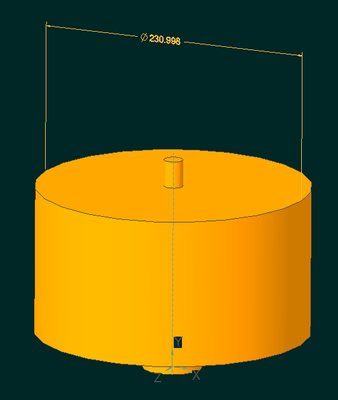

I would like to know how can I create a dimension driven (annotation) on a diameter whose annotation plane is parallel and passing through the axis of revolution?
This is what i can currently do with creo 7:
I can show dimension from revolution sketch [see dim 1 in the print screen1] : orientation is ok => I want to reproduce the same result with a dimension driven via annotation menu
If i create annotation dimension on the front annotation plane by selecting face of the cylinder, creo desn't want to proceed. I can only select edges of the cylinder but creo see that dim like a linear dim (not diameter). So orientation is ok [see dim 2 in the print screen1].

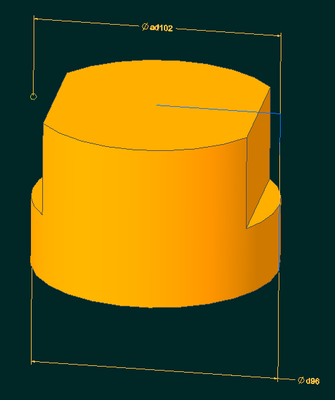

if I add a flat on the cylinder, the driven dim disappears and it is impossible to show it or re-create this dimension because of the flat. [see print screen2]  => that's why i don't want to use this way.

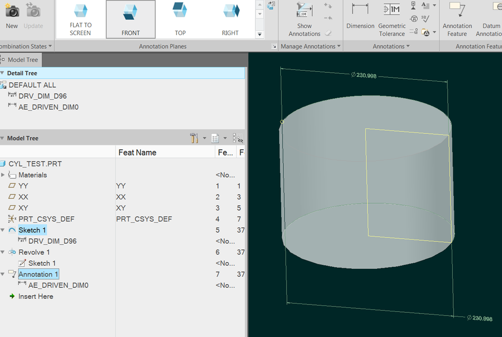

If i really want to create a dimension by selecting the face (not edges) of the cylinder, first I have to use the top annotation plane and the annotation is created like diameter driven dimension [see dim 3 in the print screen1]. But orientation of the diameter is not the one i want and it's impossible to change it corresponding of front plane.

In such situation, in order to reconfigure your Annotation Element in the good orientation, you need to proceed as follows:
  1. Create first a "Good Orientation" and Save it
  2. Then use Change Orientation capability with Right Click on impacted Annotation Element
In order to grant probably a better understanding of what I mean, I illustrated this approach for you in the little movie at the end of this post.

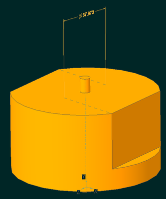

After testing I notice that if the dimension is linear, even adding the diameter symbol, creo does not understand it as a diameter and the positioning of the datum tag is not correct. please watch "diameter_KO".
If I place a diameter driven dimension (annotation), like I wanted to do from the start, the datum tag is positioned correctly. Please watch "diameter_ok"
The problem that will follow is to reorient this dimension on a plane parallel to the axis of revolution
Hello @ArnaudGOELZER
For the Diameter_KO use case, the DFS has to be placed on Witness Line of the dimenison, and not on the Dimenion.
=> Refer to attached movie reproducing your issue first, and then resolving it later on, for a better understanding.
