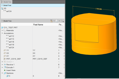

Hello @ArnaudGOELZER
In such situation, in order to reconfigure your Annotation Element in the good orientation, you need to proceed as follows:
  1. Create first a "Good Orientation" and Save it
  2. Then use Change Orientation capability with Right Click on impacted Annotation Element
In order to grant probably a better understanding of what I mean, I illustrated this approach for you in the little movie at the end of this post.
Hope this helps,
Serge
Thanks for the video!  Out of curiosity, what if you wanted the dimension to be aligned with the "right" plane, so as to avoid the flats altogether?  Would you simply change the angle of your slanted plane to 90° and it would work?
FYI, this is what happens on my system (Creo 4):
Cylinder diameter annotated as a linear dimension between vertices of the half-cylinder surface, on FRONT plane:
After flats are put in:
After changing the orientation of the annotation to the slanted plane:
(And if I change the orientation of this annotation to the RIGHT plane, then it reads 0...  Whether or not the flats are in the model)

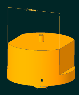

Yes, I can see how you used datum points to anchor the annotation dimension's extension lines to the entity of interest.  But how come you didn't have to do this in your first video in the thread?
Also, just to clarify: if you use the top annotation plane, then you can get a Ø style annotation dimension immediately - as the system allows you to select the circular edge; but there is no way to re-orient such dimension onto the front or right planes and convert it to a linear-style dimension?
For the Diameter_KO use case, the DFS has to be placed on Witness Line of the dimenison, and not on the Dimenion.
=> Refer to attached movie reproducing your issue first, and then resolving it later on, for a better understanding.
Hello @pausob
In the first movie of this topic, the unique failed reference was not shown in the movie but was present. The presence of at least one still working and effective reference allowed me to fix the original use case without redefining references, but "in the rule of the art", you're right, it would have been for sure better to have resepcify a good second reference (the one which was missing after extrude on only one part of the cylinder) to be in a clean situation.
Regarding your question, How to convert a diameter dimension to a linear dimension displayed in a different orientation plane? (Originally produced as "diameter dimension" as expected, due to the correct orientation plane being parallel to the skecth diameter dimension orientation):
  • If this is possible to convert it from diameter dimension to linear dimension
  • It is however not possible to Change Orientation Plane to a plane being non-parallel of the one where sketch diameter dimension exists (current limitation)
Refer to second movie for a better understanding of what I mean.
