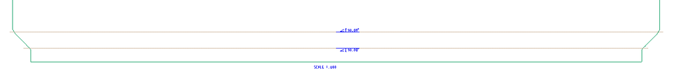

  1. Exported DXF dont have bending lines
  2. Want all SPLINES to be POLYLINES
This is DXF, but it does contains bending lines.
I want DXF to look like this:
Is there any way to export Bend lines by default when creating DXF i know options SHOW annotation and select all lines but i want default way?

For bend lines you should display them in the drawing before export
For splines to polylines use config option
intf2d_out_enhanced_ents hatch_only
or
intf2d_out_enhanced_ents none
TH_12158333
(To:Van_AG)
"For bend lines you should display them in the drawing before export"
That sucks, because the idea is to not create drawing in first place 😞
"intf2d_out_enhanced_ents none"
Thanks, this works 🙂
