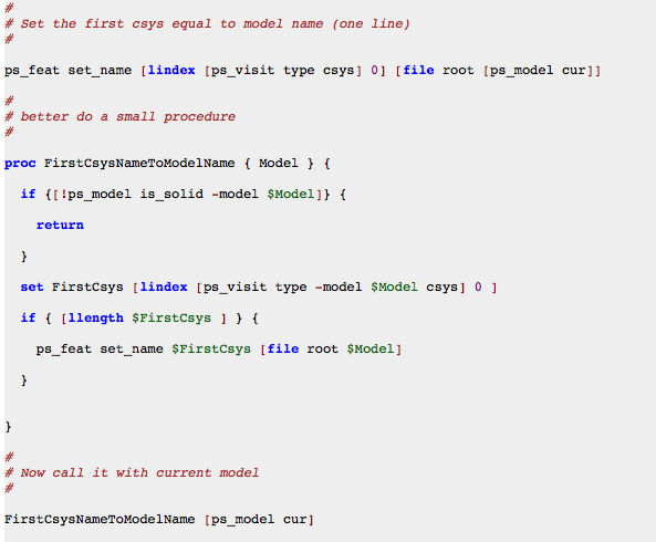

In Tcl I need one Line of code for this:
ps_feat set_name [lindex [ps_visit type csys] 0] [file root [ps_model cur]]
Next a procedure, which is more save:
Here a movie ...

You are almost right, but p-Shell is running in a SandBox, you need to copy one folder only.
The "PNG" shows the env, the movie shows what happen if you add a new folder to your SandBox programs.
  1. Start the Csys app,
  2. keep it running,
  3. do the source code edit
  4. Source the edited file again
  5. Run the newly created button
This is not a final app, but should show how easy it is to make an update or test new code.
Note: This Tcl program run in synchronous mode.
