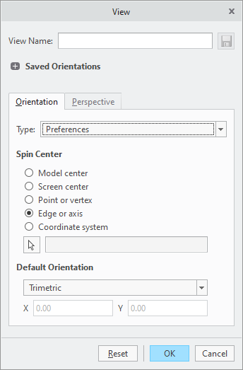

in Creo there is no exact alternative of Constrained Orbit available.
You can limit rotation using following information.
View tab > Save Orientations > Reorient > Type = Preferences
enables you to set spin center position and orientation (if you select the right reference)
Then View tab > Save Orientations > Reorient > Dynamic orient
enables you to rotate about red/green/blue spin center axis.
