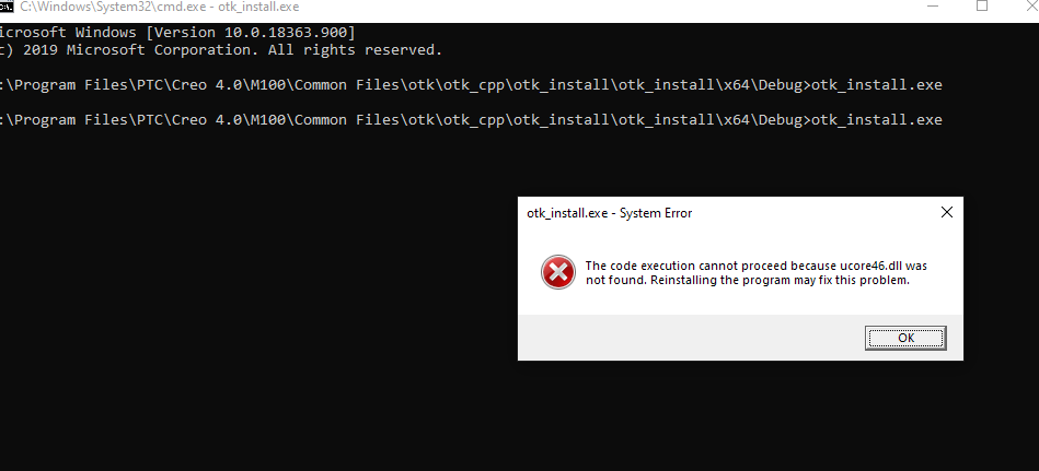

But when trying to run otk_install.exe through console i am getting this issue, should i need to change the dir of my plugin?
I found ucore46.dll in E:\PTC\Creo4_M130\Creo 4.0\M130\Common Files\x86e_win64\obj directory.
Try adding this path to PATH variable.
