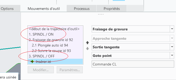

I try to find a way to desactivate the spindle (or set it to 0) between two sequences with the same tool.
Example between 2 engraving sequences at the end of the first, spindle Z return to a safe plan, rapid  move to the second sketch and engrave but all with the spindle at the same speed.
For the moment I tested with inserting CL data but i think it's not very clean and risky.
Is there a more professional method ?

I tested several solutions thanks to your suggestions. The most effective is to insert CL command in sequence. On the other hand I agree it is one of the most dangerous at the risk of forgetting to modify other parameters.
But it is only for one specific case between 2 sequences. A solution to avoid forgetting parameters that I am going to use will be to define a machining method .xml and reuse it for each case. It save the "manually add" CL commands fot the sequence.
Thanks for the help.

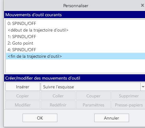

Ok thanks, i add the option, but i don't find how to turn off spindle. I try with an OPSTOP (modify parameters of the Auxiliary sequence), it works, the code is convert in M05 in my program but not with the spindle...
KenFarley
(To:RJ_FR)
If you add an auxiliar sequence, you can then use the "customize" (I'm sorry I don't know the French) to add CL commands, GOTO points, etc. It would be like you had in your first post, with SPINDL/ OFF before and spindle off after your engraving.
It's a way to have all these things you could add to the beginning or end of sequences but put them in a self-contained sequence. The difficult thing for what you want to do is to move the tool from the end of one sequence to the beginning of the next one. You might have to define a datum point to use as a GOTO point, or you can input X, Y, and Z distances to move, or whatever you can come up with.

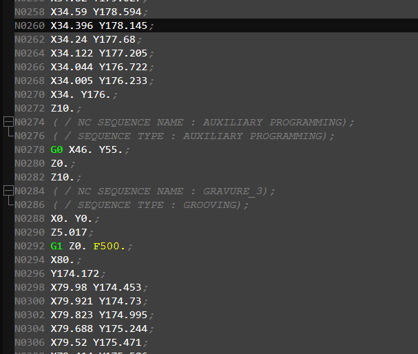

I try to add it everywhere in the sequence to be sure 😄
The Goto works but the spindle still spin !
2024-07-31 19_00_56-C__Users_jaccazr_Desktop_000 sortie post pro_op010.tap - Notepad++.png
KenFarley
(To:RJ_FR)
One possible thing that might be causing it to be ignored: did you specify a tool for the auxiliary sequence? If you did, and it is the same as your engraver, that might be why your spindle commands are being ignored. If the post sees you are using the same tool for a sequence that is already in the spindle, it might be ignoring the SPINDL/OFF commands...
If it will let you, you should change the tool to "nothing" and see if that fixes things.
