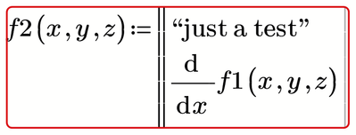

A function or a variable name is required when I define derivative as a function of all 3 variables
Cornel
Why I cannot do like f2(x,y,z) as we can see the derivative result is depending on all 3 variables x, y, and z? Should be like that for f2? Prime 10
(To:Cornel)
I would confirm that you found a BUG in Prime 10.
My first guess was that it may be due to wrong labelling of the variables/arguments, but this seems not to be the case here.
The work around using the symbolic evaluation should not be necessary.
The bug seems to concern only functions with more than two arguments, using a function with just two arguments works as it should.

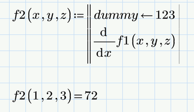

Here is another workaround not needing the symbolics. A local assignment does the trick!
Nonetheless its a BUG which should be fixed!
(To:Werner_E)
Here some other workarounds.
Crazy! As long as any local assignment is involved, Prime seems to be happy 😉
But an assignment seems to be mandatory
