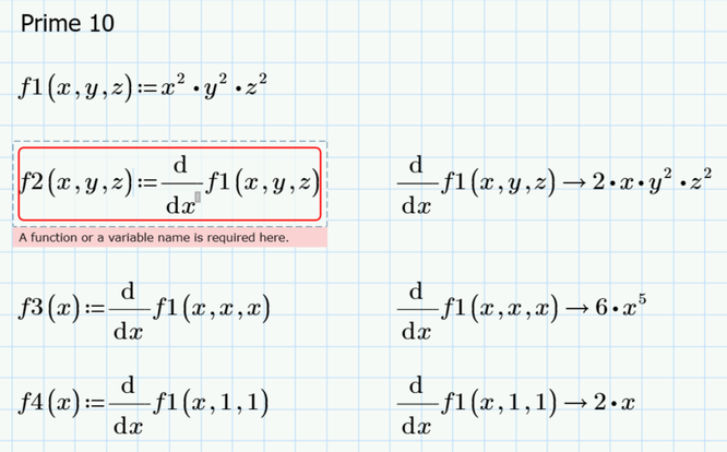

A function or a variable name is required when I define derivative as a function of all 3 variables
Cornel
Why I cannot do like f2(x,y,z) as we can see the derivative result is depending on all 3 variables x, y, and z? Should be like that for f2? Prime 10
(To:Cornel)
I would confirm that you found a BUG in Prime 10.
My first guess was that it may be due to wrong labelling of the variables/arguments, but this seems not to be the case here.
The work around using the symbolic evaluation should not be necessary.
The bug seems to concern only functions with more than two arguments, using a function with just two arguments works as it should.

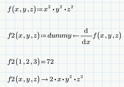

Here is another workaround not needing the symbolics. A local assignment does the trick!
Nonetheless its a BUG which should be fixed!

I think this is perhaps another bug coming along with Prime 10 as in Prime 9 is ok:

I think I found a way by evaluating the expression further, but I am waiting for others opinions if the above behaviour it should be like that in Prime 10:
(To:Cornel)
(To:Werner_E)
Here some other workarounds.
Crazy! As long as any local assignment is involved, Prime seems to be happy 😉
But an assignment seems to be mandatory

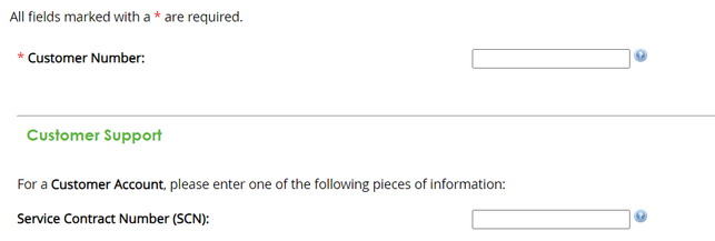

But what is the procedure for sending a bug report to ptc by the user?
In the past I was looking at this but as far as I remember at some point I was requested to sent/write some information about my license, Mathcad product code or something like this in the bug report. And I gave up at that time due to the fact that my Mathcad Prime and taking care of licesing is provided by the company at which I work, and unfortunetly I do not have the product code and access at all installing Mathcad informations. I am not sure how easy will be to request the Mathcad product code as then I will be asked by the IT team and cybersecurity guys from my company to explain and explain why I need these sensitive info, what I will do with these info and for sure they will be with eyes on me. I am not sure even if I will receive the product code by my company so easy. I do not know either what type of licesing they are using, because there are also other people as well in my company that are using Mathcad (so not just me), Mathcad installation and setup the license needed by Mathcad is done by company tool installation without employer to need to introduce the product code and stuf like this.wish the procedure for reporting a bug to be more simpler and didn't ask for so much informations. I think it's more important that the PTC to be aware of the bugs as it's also in PTC interest to improve this tool, and not people to struggle and be frustrating on the procedure of reporting the bug and in the end people to give up to report the indeed found bugs and in the end PTC to not know about all these kind of bugs that users found. I belive that a user that bought his personal Mathcad Prime can have access to his product code and all the information more easy as it's his personal paid license, and can share this info more easy. But in the case of people which work at companies and where Mathcad and licensing is provided by the company is somehow not so easy to have access to product code and other licensing and buying informations of the respective company software, as for the usual employeer of company which is using Mathcad has no easy visibillity at these informations and anyway is not allowed to share these informations without being accompanied by IT and cybersecurity  guys and requested to explain and explain...and without having to receive their acceptance to upload the produc code somewhere.
DJNewman
(To:Cornel)
It's a process, but it's not as difficult as you're describing.
https://support.ptc.com/apps/case_logger_viewer/cs/auth/ssl/log

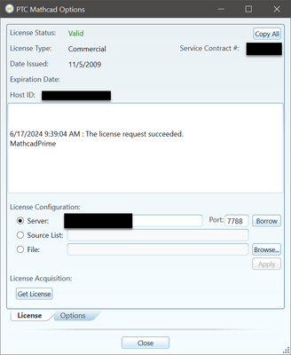

The number you ultimately need to give is your Service Contract Number. Mathcad, in-product, will tell you your Service Contact Number in the Options on the page where you configure your licence in the top right corner.

Ok, I am able to see my(company) Service Contract Number in the License tab, but I see that Mathcad is requesting me to write also Customer Number, and I am unable to see this number from Options -> License.

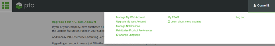

I don't know if this is a PTC thing because my access to eSupport will be different than yours, but if you click your name in the top right corner of eSupport, it should say the same of your company with a number in parenthesis. That's your customer number.

I cannot see what you said...
This account was created few years ago when I did not work at the company. So, at that time when I created this account in the creation process I did not introduced any customer number, etc.
