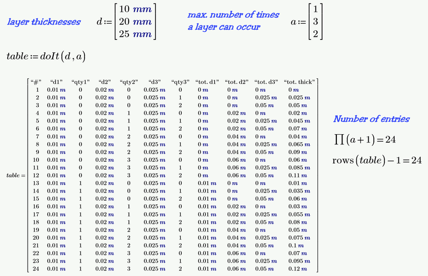

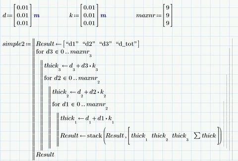

But thats nearly exactly what I provided with my generic "doIt" program if you make the two changes indicated in my reply above so that the numbering starts by 1 and not by 0. ????
Whats new and was never mentioned by you so far are the different step widths k (this variable needs to be of unit length!).
Furthermore the values in the vector you call "a" in your last sheet seem to have a different meaning now as they now are one less the number of times the value of d is taken or better its the number of times the new increment/step k is added to the base thicknesses in d, starting with 0!
So to get the 1000 entries for your three element vector d you have to chose "a" to be all 9's and not 10's!
Attached the modified program to accommodate the new changes and I also changed it so that d1 is modified first and the other values stay constant rather than doing it the other way round as in the original "doIt" program.
I also added a simple version using nested for-loops. You may change the values in the three vectors but the program will only work for two elements.
If you want to work it for three-element vectors, you would have to add another for-loop around the already existing ones.

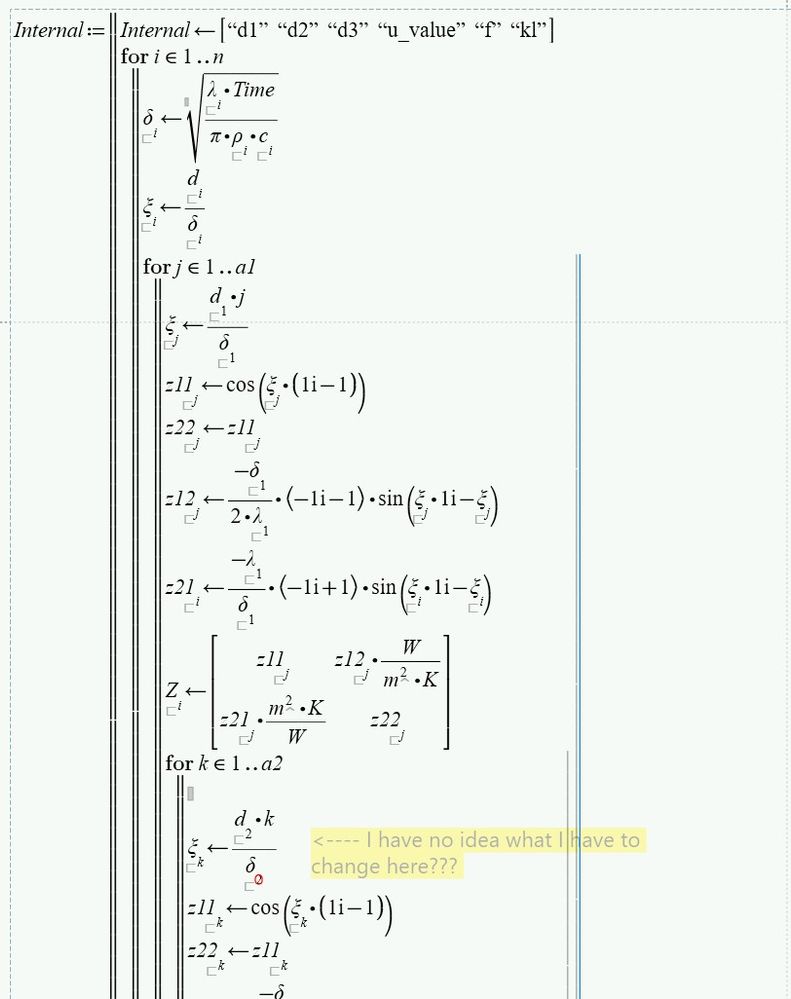

In kJ definition set label as Unit
Main loop is i = 1..n In the three times through the loop you set delta ’s three elements
in the first time through the loop you use delta 2 and delta 3 but they are not yet initialized as you have not gone second and third time through the loop yet
in the first time through the loop you use delta 2 and delta 3 but they are not yet initialised as you have not gone second and third time through the loop yet

@terryhendicott Now I see what you mentioned, Terry, but still, I have no idea how to assign symbolic ranges of a1, a2, and a3 for my variables (ksi_j the first), (ksi_k the second), and (ksi_p for the third or i-th layers? in general), respectively.

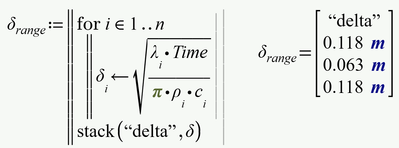

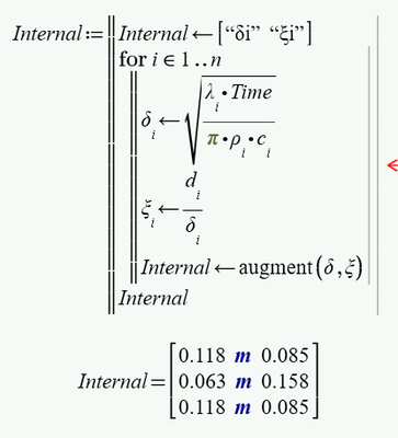

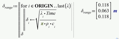

@terryhendicott, I decided to split the global goal into smaller parts.
Unsurprisingly, I have figured out. that even in the beginning, I cannot get the desired results:
For instance, I expected to receive the list of parameter delta here:
I got only one of the delta suppose of the last layer...
The iteration from 1 to n isn't works as it should ( in terms of my Matchcad experience).

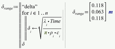

The result of a Mathcad programme always is the result of the last calculation done in the program. In your case thats the last assignment in your loop when i=n.
To return the the full vector delta, simply write delta (or return delta) as the last line of your program beneath the for-loop (nit inside the loop).
I am not sure what you intend with the variable dtot. If you want a header for your vector of values on top, you may write stack("delta", delta) as your last line.
The assignment of dtot inside of the loop does not make much sense as you would overwrite each time the last assignment done.
You may use
or
And if your dtot assignment should have just been a programmers comment, you may use the string alone without assigning it a variable
BTW, to be independent from the setting of the system variable ORIGIN (you have set it to 1) and also not needing the variable "n", you may define the loop shown in the pic below

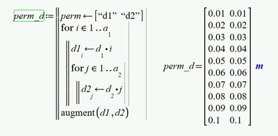

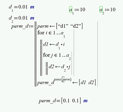

@Werner_E Thank you, Werner. You clarified my MAthCAD black box a little bit.
May I want to create the list of permutations without repeating of two values d1 and d2 being iterated with i-th and j-th increments:
As I get from the output - its smth huge which is the values production result...
Nested loop assign to each j-th value i-th value. For instance
d1=0.01m
d2=0.01m
range1: a1=10
range2: a2 =10
for i E 1... a1
for j E 1... a2
d1<-i*a1
d2<-j*a2
What I'm expecting for in output
permut_d = [ "d1" "d2"]
[ 0.01 0.01]
[ 0.01 0.02]
[0.01 0.03]
[0.1 0.1]
If we have 2 positions with 10 possible numbers in each one the total permutation will be 10^2 =100.
As well other modification doesn't reflects my expectations:
I convinced that there are simple and elegant solution does exist.

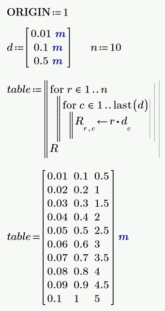

A similar table could be created a bit simpler with a code like the following
When I used "r" and "c" I was thinking on "row" and "column", when using "R" I had Result or Return in the back of my head.
Because I collected the d-values in a vector I could use a second loop for the columns.
If you have distinct variables and don't want to collect them in a vector, you could use just one for-loop for the rows and use the row-operator when assigning the three values. As usual there are many ways to skin a cat ...
If you need further assistance, please ask a specific question and attach the Mathcad sheet if necessary.

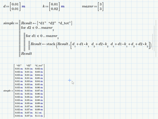

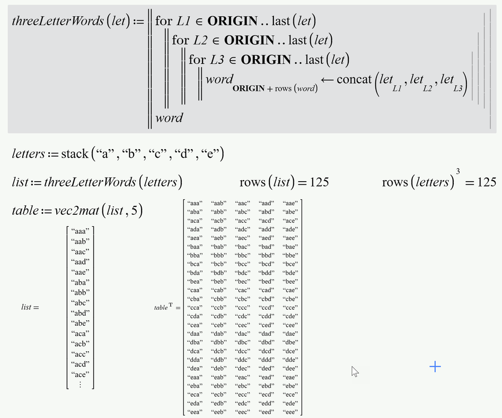

To get the 1000 x 1 vector which you seem to expect, you could program 3 nested loops (for the 3 thicknesses d), each running from 1 to 10 (or better from 1 to a_i). Maybe the loops should run from 0 to a_i if you want to also deal with the case that one of the layers is not present at all.
This approach with nested loops of course is quite inefficient, especially if you think of modifying the number of available layers (d). You mayl find more efficient, general and elaborate algorithms for programming permutations in the literature and may try to duplicate them in a Mathcad program.
Here is the brute force approach with nested loops for the example with the three letter words. As you can see it would be quite easy to change the number of available letters, but it would require to change the program code if you intended to change the number of letters in the final word.

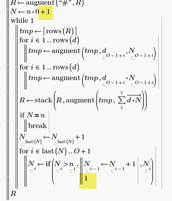

My concerns were not about time consuming calculations - after all you have to calculate 1000 results anyway.
My concerns were about the need to change the program in case you add more layer thicknesses (d).
Here's a quick hack (sure could be done shorter and more elegant) but I am not sure if you are looking for something like that.
In case you don't like that the quantities also include zero, you have to make two modifications

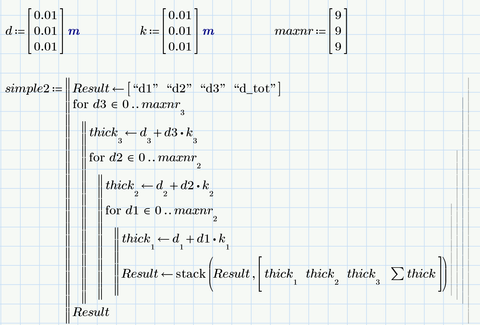

@Werner_E Sorry for the unclear explanation of my issue.
I suppose in the attachment now, you'll get it

Thank you for your patience and desire to help, Werner!
It looks pretty cool and could be used and intended for several coding realisations.
This code (sample2) looks more understandable (as for me).
