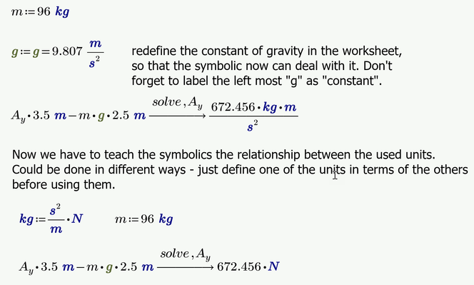

Hi everyone, when i got a new laptop and donwloaded mathcad again, im suddenly having different issues with it i didnt before. Like when using the solve function it cant give me the answer if i use units in 1 scenario. In the other it gives me the answer as "cos(30deg). Anyone knows if its something i can fix?
The one above is supposed to give around 673N.
This one is supposed to give 0,87kN.

Turning on the option "Units/Constants in Symbolics" sure is a good idea and you should have turned on on per default.
But it doesn't tell the symbolics the meaning of predefined constants and relationship between units, it just lets the symbolics retain the labels "Unit" and "Constants".
Without this option enabled:
Note on the right hand side that the symbolics turned the unit m to a  normal variable m (its not set in bold blue anymore).
That way you would run into troubles if you try to evaluate the 'result' numerically:
This is what turning on the option cures:

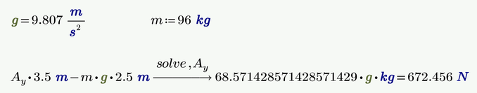

Note that the 'm' on the right hand side now is still correctly labeled as unit and so the numerical evaluation works OK:
But even with the option active, the symbolics knows nothing about the relationship between different units or the definition of constants.
You see that the symbolics does not know how seconds and minutes are related or how the gravitational constant is defined. It regards all these quantities as independent unknown variables. But since the labelling as a unit is not lost when the appropriate  option is activated, the result expression can at least still be evaluated numerically (or saved in a variable).
The shortcoming that the symbolics cannot handle units is not new in Prime 10. It was exactly the same in all previous versions and was no different in real Mathcad (version 15 and before)!

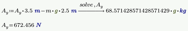

So concerning your problem #1 it should be now clear that the symbolics is not able to come up with 672 N as result, but you simply could numerically evaluate the symbolic result to get the desired display
or assign the result to a variable and evaluate it numerically

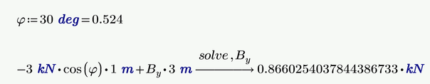

According your problem #2:
No! Sure not! Where should the unit kN stem from? The unit meter cancels, no other unit is in play and so of course the result must be a dimensionless number!

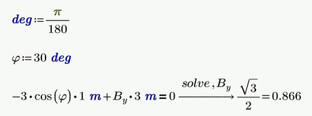

The symbolics does not know anything about the definition of "deg" or its alias "°".
So either define your angle in radians
Or you may also (re)define the 'unit' "deg" before you use it the first time, so that the symbolics knows how to deal with it:
The symbolics returns an exact result if possible and if you rather prefer a numeric result from the symbolics you have to use the modifier "float,...".
If you wish to see the result as a force, you would have to define the first factor "3" as being a force
There is also one way to get the desired result without having to use radians or redefine "deg". You may use a numeric inline evaluation when defining the angle. That way the variable is assigned that numeric value and the symbolics will use it. But doing so you won't get the exact result.
