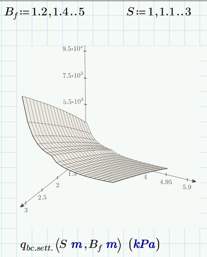

Thank you @ttokoro . What is purpose of using third brackets " [  ]". Is this for assigning the matrix values in each corresponding cells inside the "Ans"
ttokoro
20-Turquoise
(To:fahmed-2)
Your sheet shows error mesage for x and y data must have no unit. So I make Ans as [x y z-value with unit].
And stack all S and Df  and  its Ans.
I try to use [NaN NaN NaN] to stack. In this plot, z axis also has no unit.

In fact, the error message reveals the cause and also gives the hint to the solution of the problem:
The variables for the independent variables (x, y) must (unfortunately) be unitless. Only the dependent variable (z), i.e. the function result, may have a unit.
So omit the unit meter at the range variables and add them when calling the function.
The plot takes "endless" to finish because the function seems to be defined quite inefficient.
You sure should consider to implement the improvement I suggested in another thread of yours which at least speeds up the calculation for the factor 5.
Personally I would prefer using CreateMesh() instead of range variables

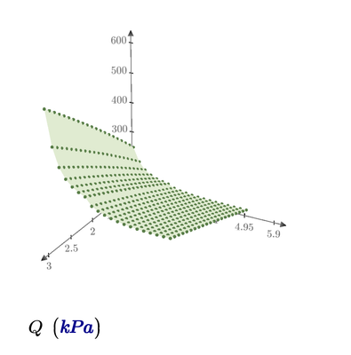

Thank you @Werner_E . Is it possible to make the plot as individual dots
(To:fahmed-2)
Sure! Simply format the plot that way
I used the data  structure created with CreateMeashj() but you can do the same with the plot using the range variables.

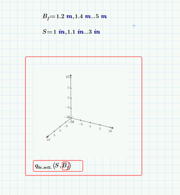

Also, I am having the following image using your process @Werner_E . The box was marked "red". Please help
(To:fahmed-2)
And the error message is?
As far as I see your comp is still computing......
Personally I would prefer using the CreateMesh() function anyway
File (Prime9) with a speedier function attached

Thank you @Werner_E and @ttokoro . It works great. I was wondering how to extract values from the Mesh function. For example, here, if I need all the values of Q for different values of B_f at a constant S or, get all values of Q for different values of S at a constant B_f. Please help.
(To:fahmed-2)
Q is a nested vector containing matrices for the x, y and z values of the points to be plotted.
If you need the value for a specific S and B.f value, simply use the original function to get it, not Q.
And if your goal is to highlight some specific positions in the 3D plot, you could do it as shown here

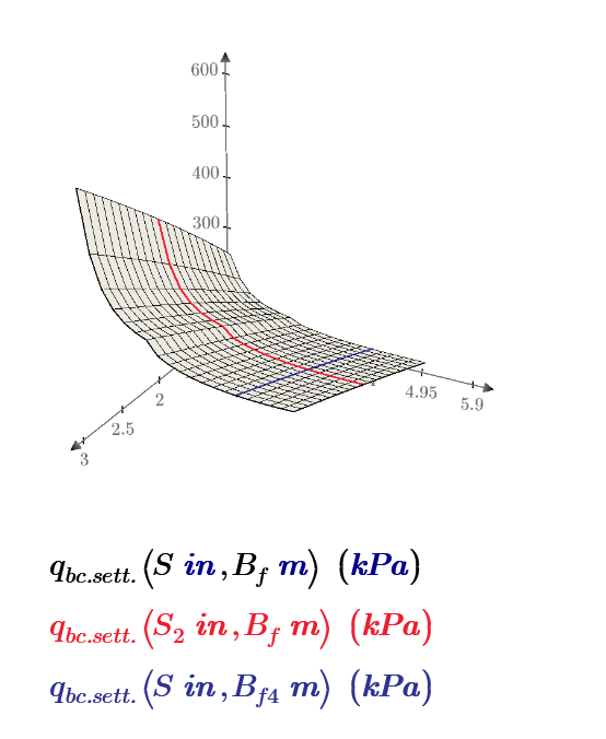

Can alternatively be achieved using CreateSpace()
May be formatted with lines and/or points. Unfortunately Prime provides only one size which is equally valid for points and lines. Workaround would be to use two plot traces 😞

Thank you @Werner_E . This is awesome!! Please advise as why did you put numbers 40 and 60 for defining A and B, respectively.
(To:fahmed-2)
Just to get a finer resolution. Default value would be 20 if you omit this parameter (see the help info for CrreateSpace()  and also for CreateMesh() ).
As you can see in the picture I also used a finer grid for the surface, too, to et a bit more details. It takes longer to calculate, but as I implemented the already mentioned speedier function we can wait for it to finish.
