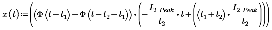

Hello Guys!
I want to analyse my circuit, using laplace transformation.
Step 1) First I have to generate a triangle waveform.
I have all informations given like peak-value, duty cycles, frequency, and so on.
I could obtain a triangle waveform by defining sections with the if-equation, according to the post from Werner:
https://community.ptc.com/t5/PTC-Mathcad/Plots-for-Conditional-Function/td-p/124048
My first idea was to multiply a sawtooth function with a rect function, but nevermind. I keep the solution from Werner I guess if the following Step 2) will work...
Another approach would be a fourier row to obtain the triangle shape. Maybe you have some older work / examples here for me?
Step 2-4) I want to make a Laplace Transformation from the triangle waveform, means: i(t) -> I(s)
--> is it posible with my function from Step 1) to do a laplace transformation, or do I have to go the approach with fourier rows?
(Step 3) Vout(s)=I(s)*G(s), with G(s) = Transfer-function of a circuit
(Step 4) Inverse Laplace Transformation Vout(s) -> vout(t) and plot

Here's an example, first your triangle:
Don't try to use the repetitive signal, due to the mod() function, the Laplace transform will not carry through:
Now we need G(s), to calculate X(s). As an example we take a simple Low-pass filter:
From here, apply the inverse Laplace transform to obtain x(t):
(Yes, it's a big expression)
And plot f(t) and x(t):

Very first check: see if the Laplace transform likes an 'if'-statement. I know it deals with the Heaviside step function OK, but have my doubts about if...
LucMeekes
(To:LucMeekes)
And even if you succeed in finding the Laplace transform of a triangular waveform, which, according to Spiegel "Laplace transforms":
for a triangle with amplitude A and period T and no offset, will be something like:
Then on trying to apply the inverse Laplace, you (may) get:
which means that the inverse Laplace isn't known.

I found another method to define a (symmetrical) triangular waveform:
Unfortunately the Laplace transform isn't found by Mathcad:

Shouldn't you replace t.3 in your definition of f(t) by T. After all t.3 seems to be a duration, not a time stamp.
As Luc already wrote, the symbolic "laplace" does not work with conditionals (if's).
I am also not sure about trunc and/or mod (which you would use to make a periodic signal) and the used units. After all the symbolics does not know anything about units and treats them as unknown variables.
Using Fourier would require you to trunc the row and would just be an approximation.
EDIT: I just gave it a try and redefined f(t) using the Heaviside function as suggested by Luc.
We can laplace transform f(t), but as soon as we use "floor" to make it periodic, the symbolic is not able to transform it in a usable way - you see the calls to a (non-existent in Prime) laplace-function in the result.
I haven't tried, but I guess that different ways to make the signal periodic (using the "mod"-function e.g.) will have no success, too and you will have to resort to other methods to solve your task. Maybe the pdfs of @-MFra- , posted by @Derbigdog  will be of help.
