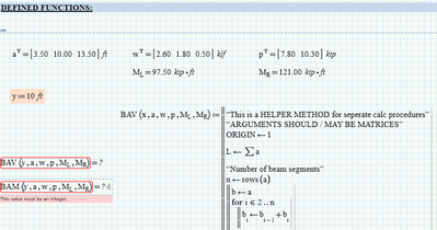

This is sort of a follow-up question to this thread where I was recreating the calculations of the ptc sample:
Once I got that working, I defined two functions that process the spread-sheet wide variables, which was working "properly" for me:
     a = [matrix]     w = [matrix]     p = [matrix]     ML = number     MR = number
When I tried to move all arguments into the function definitions and I am getting error: "This value must be an integer."
     M(x,a,w,p,ML,MR) and V(x,a,w,p,ML,MR)
I'm having trouble figuring out what is causing this. Can anyone point out what I am missing?

Your new problem occurs because you used a range in your program. In programs you have to use for-loops instead!
