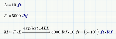

Instead of the current way:
L :=10ft
F:= 5000 lbf
M=F*L=50,000 ft-lbf
It would solve like this:
L :=10ft
F:= 5000 lbf
M=F*L= (5000 lbf)(10ft) = 50,000 ft-lbf
It would help checking calculation packages especially if defined variables are coming from a referenced  worksheet file or 50 pages earlier.

Did you know that you can achieve a similar effect than the one you demand by using the symbolic evaluation with the modifier "explicit, ALL"?
The method has its limits, though.
In real Mathcad we could hide the text "explicit all" and make the arrow look like an equal sign
but unfortunately Prime does not (yet?) provide this features.
