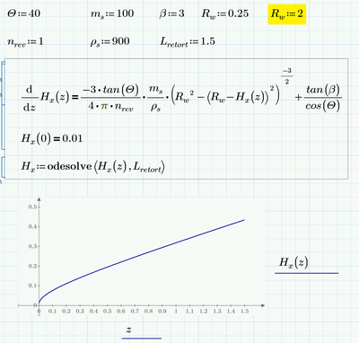

I am attempting to dynamically model the behaviour of granular solids in a rotary kiln using known equations, however i am having trouble setting up the following ODEs in mathCAD for the model....can anyone help. I have included the key points i am trying to model in Mathcad.
boundary condition: boundary condition.PNG
where h0 is a fixed value (say 10% of the value of R).
From the above i'm looking to be able to determine the bed height (h) at any axial location (z) along the kiln tube.
Subsequently equations for Cross section area of the granular bed and residence time of the granular transport through the kiln (as a function of bed depth (h)) follow on from this...
Cross section area:
Residence time
So essentially i am looking to use MatCAD to find the residence time (t), given fixed values for: n (rotation speed in rpm), R (radius of kiln in m), D (diameter of kiln in m), angle of repose of the material (beta), angle of inclination of the kiln (theta), mass flow rate (ms) , bulk density of material (rho), axial length of the kiln tube (z).
My initial attempt using ODEsolver block did not get that far and with limited success (see attached) and seems very temperamental depending on what values are used and cannot utilise units for the variables (hence why they are all unitless.

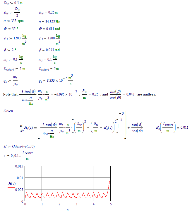

LucMeekes
(To:Pyros1111)
Your rotational speed may be a litle low. 1/3 of a rotation per minute apparently isn't enough, 333 rotations per minute does give a solution.
Mind that you don't have to use the UnitsOf function to cancel units, and 'rad' is a unitless 'unit' anyway. You can also divide the units out directly.
See below.
Then, with Dw reduced to 0.5 m,and the minus sign in front of the derivative removed, I get:

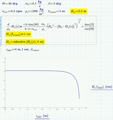

Pyros1111
(To:Werner_E)
when i tried to put the relevant units in (ant altered the values accordingly) it didn't want to work - various warnings (see attached). Any pointers?
(To:Pyros1111)
  1. The initial conditions must be given with the appropriate units. Its not necessary to write 0m instead of just 0, but its good habit to do so, too
  2. The solve block fails if R is lower than 1.97 m. You'll have to check your equation or the other values assigned if you think that R=0,5m should yield a valid result. I notice that you changed several values compared to the file I posted (where R must had a value of at least 0.502).
  3. To plot with units on the abscissa you need to define a range variable. I have chosen z.plot as the name for this variable which is only to be used for plotting, but you can chose any name you like (even simply z :-).

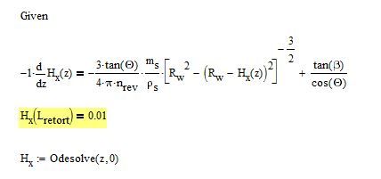

I was also trying to alter the initial condition for Hz as its not correct and should be Hz(L)=0.01 rather than Hz(0)=0.01 however this doesn't seem to work? does something else need to be changed?
(To:Pyros1111)
@Pyros1111 wrote:
thanks for this - i see how that works now.
Alan already solved that. Its as simple as writing the desired inital condition in the solve block and set the "end" value to zero. No R can be a higher value, too.

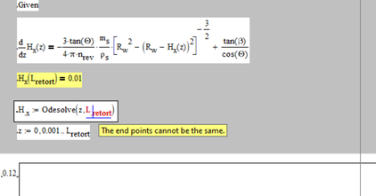

hi again,
thanks again for your previous reply - i have been looking over it and trying to use the more accurate values to see what comes out and noticed i had initially described the inmitial condition for the ODEsolver as Hx(0)=0.01, whereas what i wanted to do was define it as Hx(L) = 0.01. However, when i do this in the Mathcad (See attached) it doesn't work and says the endpoints cannot be the same in the solve block?
can you explain why and how to make it work for this end constraint please?

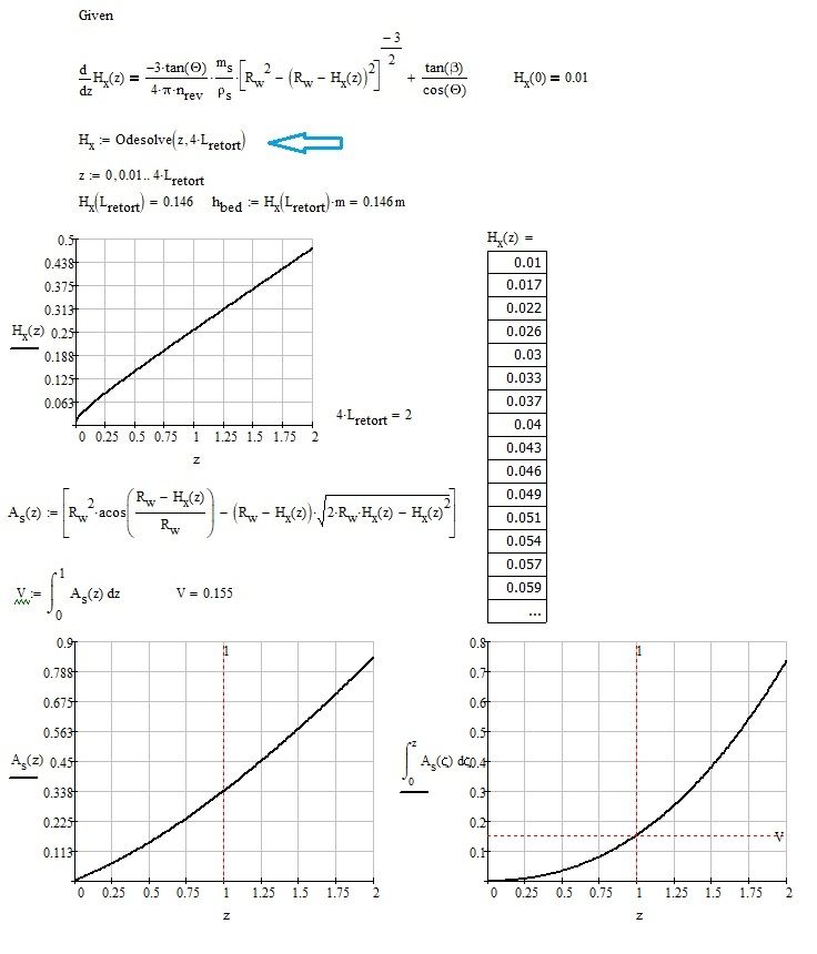

Try integrating in reverse from Lretort to zero:
See attached.
Alan
