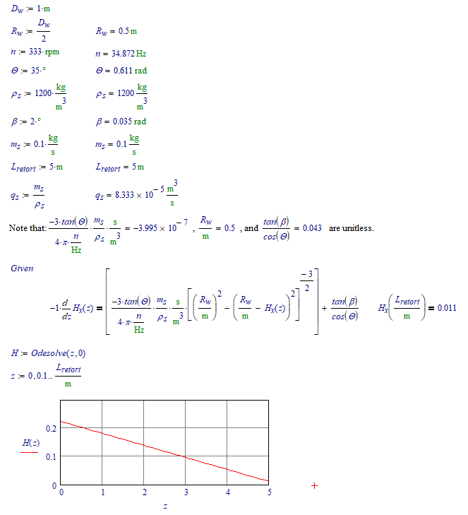

I was also trying to alter the initial condition for Hz as its not correct and should be Hz(L)=0.01 rather than Hz(0)=0.01 however this doesn't seem to work? does something else need to be changed?

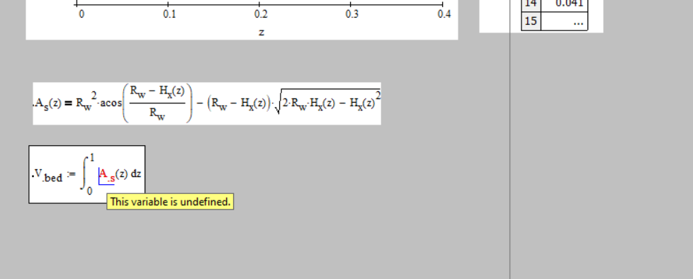

Pyros1111
(To:-MFra-)
sorry to be a bother again but when i try and put this in it still doesn't seem to work properly for the last bit - says variable undefined??? any pointers on what im doing wrong?
Pyros1111
(To:Pyros1111)
my fault - was using a Boolean equals sign.

hi again,
thanks again for your previous reply - i have been looking over it and trying to use the more accurate values to see what comes out and noticed i had initially described the inmitial condition for the ODEsolver as Hx(0)=0.01, whereas what i wanted to do was define it as Hx(L) = 0.01. However, when i do this in the Mathcad (See attached) it doesn't work and says the endpoints cannot be the same in the solve block?
can you explain why and how to make it work for this end constraint please?
Try integrating in reverse from Lretort to zero:
See attached.
