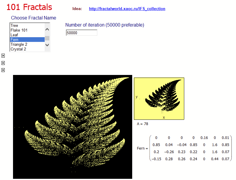

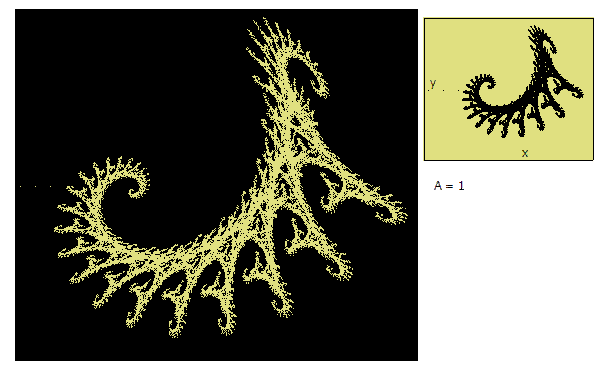

Maybe not exactly what you are asking for (beacuse I guess you had Prime in mind, not Mathcad) but this thread possibly can give you some inspirations for own attempts.
Fractals in Mathcad - PTC Community
Viktor's sheet uses xy-plots to show the results, so it may work in Prime as well (apart from the list box for selecting the fractal type). For testing purpose you may manually set variable "A" to a value from 1 to 101.
Creating a bitmap would provide better resolution and (if desired) a wider range of different colors. Its a real PITA that Prime does not provide an image operator and so bitmap images created could be displayed automatically directly in the sheet.

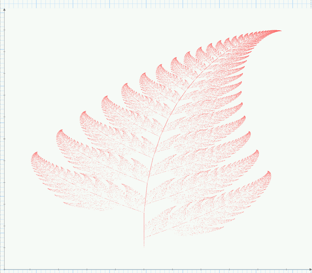

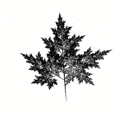

Fractal A=78 uses exactly the IFS matrix for the Barnsley fern:
August 21, 2025
I wondered why Viktors sheet won't render the stem of the fern and found the error in two parameters of the first iteration function which where erroneously exchanged. It should read
August 21, 2025
Here is the Prime 11 version with @Werner_E correction to get stem of fern.
The list box works on conversion.

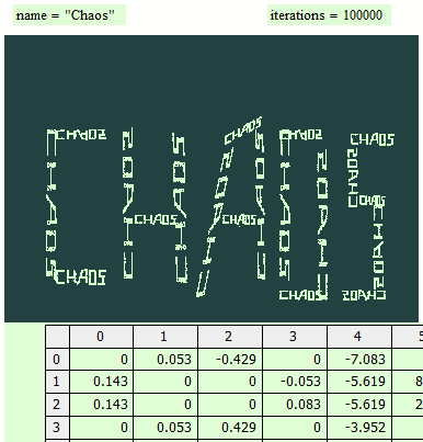

Here is my version for plotting IFS driven iterations.
My approach uses a function to come up with the final coordinates instead of range variables so we could inspect multiple different fractals side by side.
Also the function does not mind how many iteration function are defined - it automatically deals with the number of functions provided in the matrix.
I also automated the creation of the list box to select a fractal. Once a new fractal type is added to the list (providing a name and the IFS matrix) the list box automatically updates and presents the fractal names in alphabetical order.
This uses a scripted component and the converter was not able to convert it correctly to a scripted Prime component. Rather the Prime file remains unusable. Its a shame how much work and modifications we have to apply to make a converted Prime sheet to look and work as expected.
Because scripted components are used you have to answer the security query at load time with "no" in case of Mathcad and with "yes" in case of the Prime sheet 😉
The plots are so much limited in Prime that its not possible to duplicate the look we have in Mathcad. We cannot remove the axis, cannot set a background color and as our plots uses more than 5000 points we are not even allowed to set the size of the points plotted which come out far too tiny.  So to have at least the best contrast available the plot is made in black in pure white background. Too bad!
Even when I do likewise in Mathcad its quite a difference to the Prime result:
I have added a couple of fractals from Viktor's sheet but not all (just 25 of the 101 provided in Viktor's sheet). Feel free to add more fractals from Viktor's sheet or make your own attempts. It should be quite obvious how to add more fractals to the list.
Attached are my original Mathcad (15) sheet and the converted and reworked Prime 11 sheet.

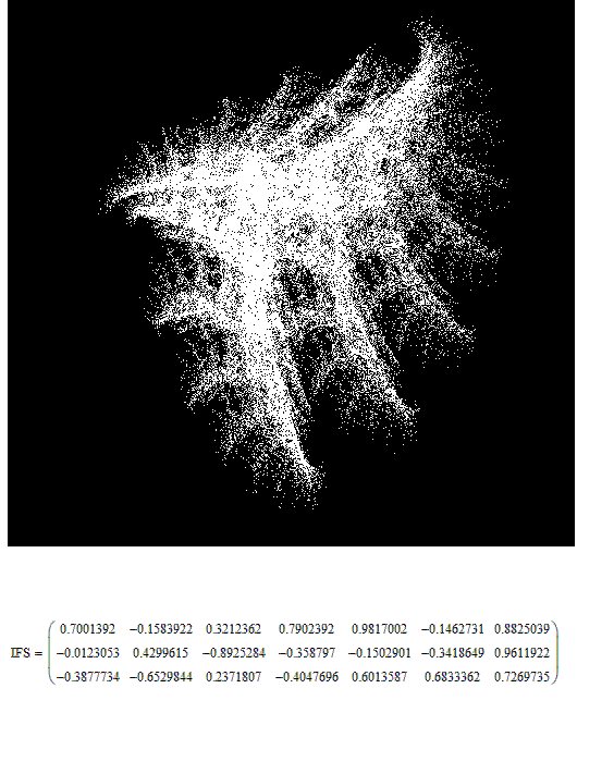

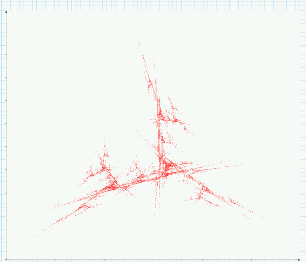

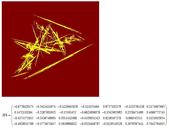

EDIT: Added random IFS in P11 sheet. So far no remarkable results. The best so to day has been
Note that the last column are not actually probabilities  (otherwise they would have to add up to 1). My program turns them into probability values by dividing them by the sum of that column.

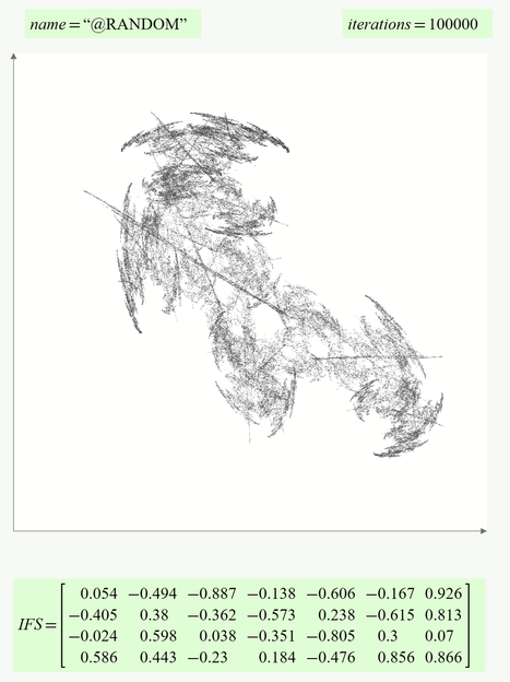

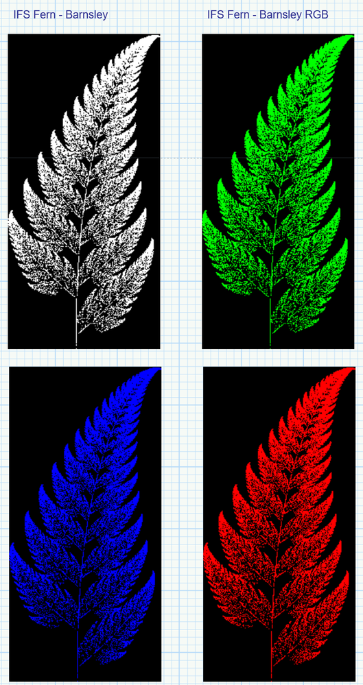

Here's another (probably very similar) take on the Barnsley Fern.  It's a slight revamp of an old (Mathsoft) Mathcad 11 updated for Mathcad Prime 11.
2D Plot - Barnsley Fern
Greyscale Bitmap - Barnsley Fern and Variants
RGB Bitmaps - Barnsley Fern

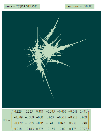

2D Plot - Random (Babylon 5 Shadow!)
Clearly still needs work.  I used the ComboBox in an earlier Mathcad Express 7 variant, taking advantage of its inline capability.   I've got another development worksheet that I've just added a ListBox to, but I don't know how to inline it.  It would have been nice to have an Advanced version of the ListBox, so that I could easily automate filling it from the IFS library in the attached worksheet.
