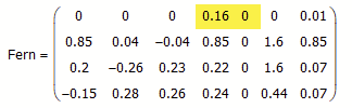

In the attached file - a collection of 100 fractals. Used IFS formulas. If you want to add a collection - you're welcome.

I just found @ViktorKorobov's work today, and I'm really impressed. Thanks for sharing!
I noticed a small error in the IFS matrix for the Barnsley fern, which prevents the fern's stem to be generated.
Two values in the first row of the “fern” matrix need to be swapped, so it should read as follows:
