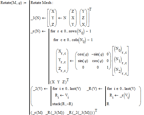

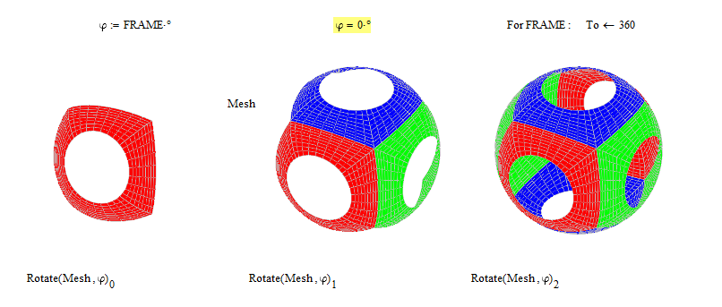

Hello, Stuart. 😊
Regards.
Loi.
( Correction of previous post : )
