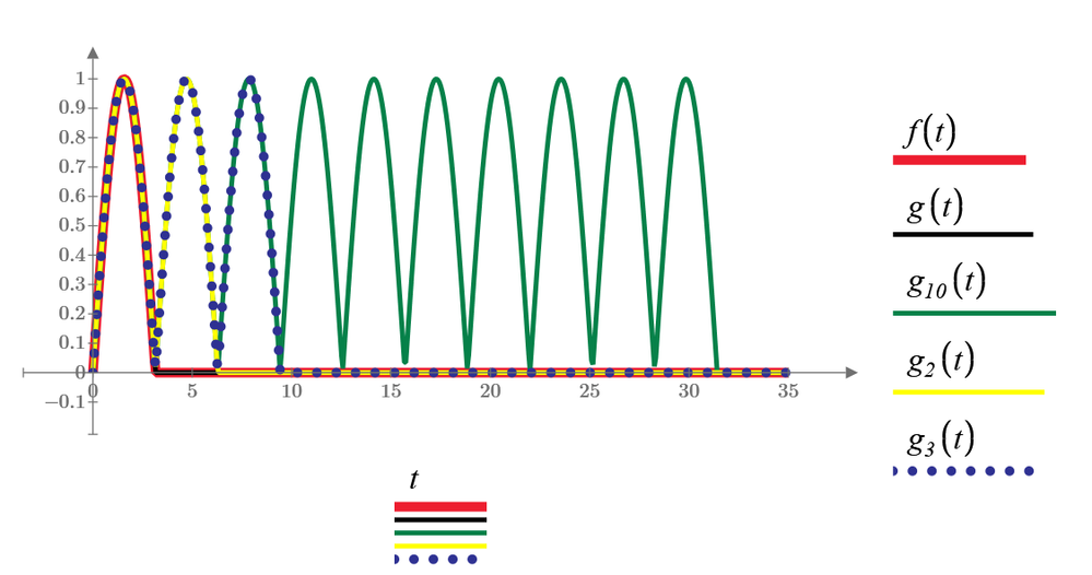

And Wolfram Alpha isn't able to come up with the desired result |sin(t)| either:
(To:Werner_E)
In Mathematics the absolute function is kind of a beast which usually is quite hard to handle.
Much more difficult like a simple function like the squaring
or even the Heaviside function
(we see "1" instead of "Phi(t)" because the result of course is valid only for t>=0).

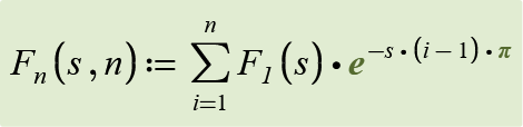

We could try to rewrite the absolute value using the modulo function, but unfortunately the laplace operator can't deal with the modulo function
