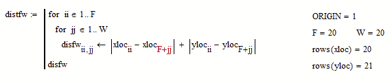

I am carrying out the coding of the optimization task in Matlab, from the attached sheet, to the Mathcad language. But I am stuck at this point.

xloc is a 20-element vector with elements numbered from 1 to 20 (because ORIGIN is set to 1).
You try to access an element with an index larger than 20 - hence the error.
Similar wih yloc, which is a 21.element vector.
xloc and yloc would both need to be 40-element vectors for that code to work OK
