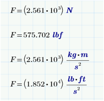

For users of PTC Creo, we often find that Mathcad is also used, to keep issue outline by serving you to comprehend usual units, conversions, and compatibility. If your formula is conniving in meters (m), you can change the element to millimeters (mm) and Mathcad handles the conversions and simplifications behind the scenes. Or if you need calculations to convert units of mass, pressure, and voltage, Mathcadhandles those, too. If you try to calculate opposed units, Mathcad flags the formula so you can correct it. This background conversion and checking are handy if you regularly deal with companies that use different systems, like metric and imperial. Mathcad will let you combine compatible units – you can add force in N and kN or lbf.
Mathcad will flag errors when trying to combine incompatible units – you cannot add force and velocity.
Mathcad will carry units throughout all calculations, so you can keep them explicit.
Mathcad lets you choose which unit system or which specific unit to display the result in and will do the conversion help for you. This way you can solve your homework using this formula.
