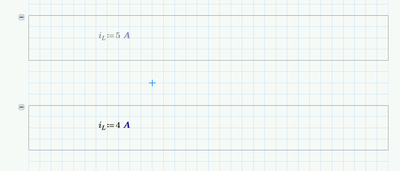

Hi experts.
I would like to know.
If I could use command method to enable the calculation area or disable it.
For example,
I have two condition, in one condition I want iLr = 5A, in the other condition, iLr = 4A.
I know I can use "if" command to do that. but sometimes I prefer to disable/enable area.

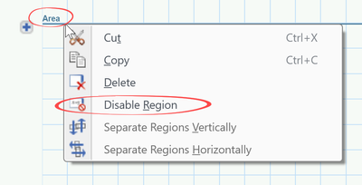

You can select the whole area and use the right click menu to dis- or enable all regions in an area.
This can also be done if the area is collapsed.
You can tell that the area is selected when its collapsed by the small text "Area" on top of the line next to the plus sign

Hi @Werner_E ,
There is no command I can disable it or enable it, right?
I can only right click the menu to disable/enable it.

Command?
You may use either the right click menu or you you the menu item "Disable Region" from the menu - Ribbon "Calculation"-Section "Controls". It work not only for single regions but also for multiple regions or all regions in an area.
Got it, thanks.
