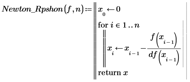

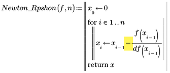

MC Prime 8 file attached.
Thank you.
ttokoro
(To:Cornel)
Chage xi-1 - and -> to =

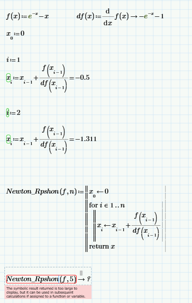

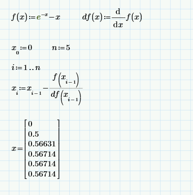

As Newton-Raphson is essentially numeric there is little point in using a symbolic equals.  Just stick with numerics.
Here is my equivalent using Mathcad 8 Express:
Alan

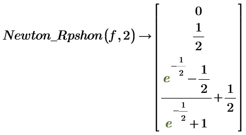

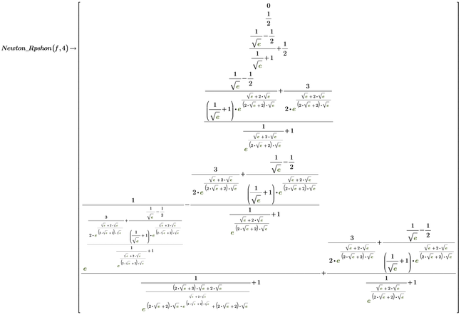

As Alan I am asking what the idea of a symbolical evaluation of the intermediate results of a numerical approximation algorithm might be!!

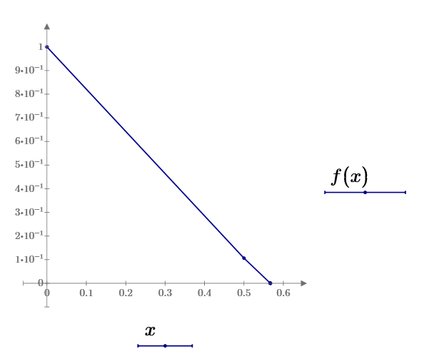

Whats wrong with
BTW you had a wrong sign in your implementation of the Newton algorithm. See Alan's approach for a correction.
Here is the (unsimplified) symbolic result with four iteration steps.

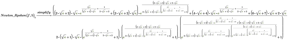

Are you sure that you really want to see the result for 5 or more steps? 🙂
Using "simplify" or "simplify, max" may give you a more compact result at the cost of a lot of coffee to drink while  waiting for the calculation to finish.
But again, what's the sense of displaying those results symbolically?
(To:Werner_E)
If you really need to see the symbolic representation of the fifth iteration step, here it is
And for an exact symbolic result
