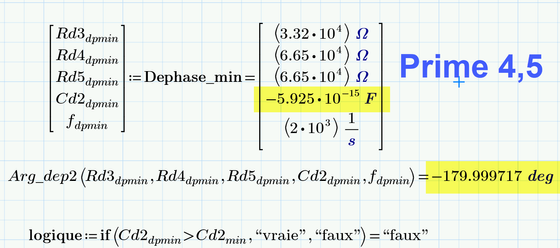

I tried the sheet in Prime 4,5,6 and 9 and experienced different behaviour in 4 & 5 compared to 6 & 9.
Changing TOL and CTOL does not have any effect in either version:
Older versions seem to not fully respect the constraints (probably because of the low values) which obviously was fixed in version 6 and above.
EDIT: @Christophe.fr
You can "weight" the constraints by multiplying the values with a large factor
This seems to have the desired effect in Prime 4, too:
You can play around and do similar (maybe with different factors) with the other constraints as well.
BTW, your constraint
does not have any effect at all - DeltaT will be 45 throughout as you had defined it.
What did you think this constraint would be good for?

Hi Christophe, Werner
I am suspicious of the minimize algorithm is not resolving correctly.
Two corners of the solution that meets the constraints as shown in the worksheet are at a lower value than the found solution.
Cheers
Terry
Minimize is also dependent on the guess values - it won't be able to find the absolute minimum, just a local one.
So changing the guesses might give a better result. The solve block seems to be VERY sensible wrt the guess values and tends to fail if a guess is even changed only slightly.
Furthermore "minimize" minimizes the "errors" and here they seems to have changed the way the errors are seen with respect to the constraints when going from Prime 5 to version 6.
