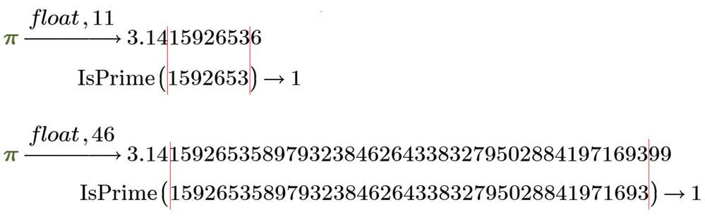

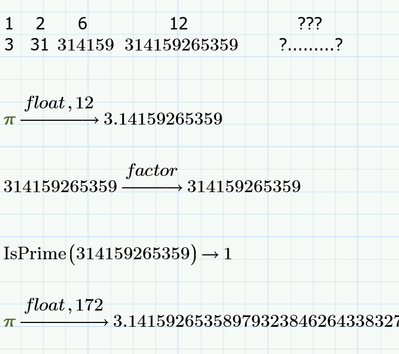

I know four Prime numbers from Pi without point.
Do you know more?
2) How we can find this numbers not manual - by programming?
3) It the problem correct and solved?

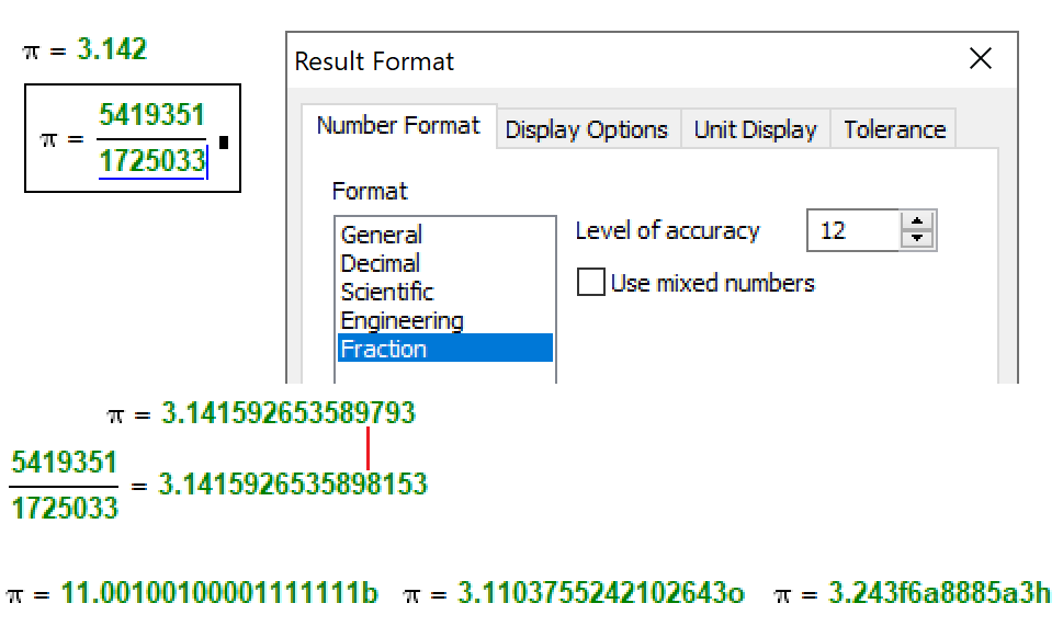

Your last number is only correct if you use rounded numbers. The last 9 is not a digit of pi.

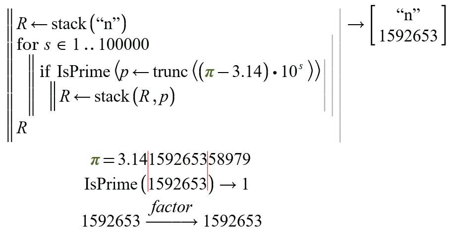

I guess Mathcads symbolics will not allow us to find more of that kind of numbers. The float command is limited to 250 significant digits (which also means that I should have used 249 instead of 251 😉
You'll have to use a more capable program for further investigation, maybe good old Derive could be of help as there the number of digits is limited only by available memory (but being rather old I suspect it will not be able to use more than 1 GB). How about the abilities of Maple?
Remark: As Stuart has show with his attempts below, those routines will only provide numeric IEEE precision. So only numbers up to 15 significant digits can be found, no matter how large s is chosen.

While the new symbolic engine allows values larger than 250 in the "float" modifier, it fails in the program if "s" exceeds 20 😞
The error message is "Unknown error: Integer_expected"

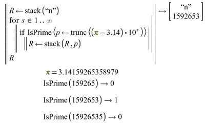

Correct in which sense? If there is another prime starting with 159... then it would have more than 250 digits.
It doesn't help to let s going beyond 250 - it just takes up more time.
EDIT: Wrong, as Stuarts program had proven below. With my routines only numbers up to about 15 digits can be found. Obviously they suffer from numeric IEEE limitations even though evaluated symbolically.

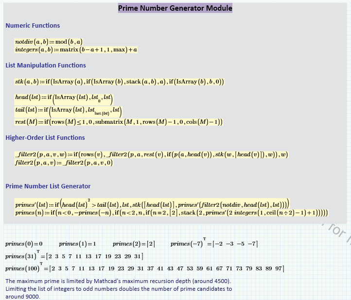

Prime number finder in Express
If you need an Express prime generator good for about 1000 primes (primes up to 8999), perhaps the following may be of service ...
The "module" is standalone in the sense that you can just copy the whole text region and paste it into a worksheet (taking care to avoid any name clashes).

I've only got Mathcad Express, so symbolics and large numbers are not directly available.   However, it is possible to generate an arbitrarily long sequence of digits for pi by using a spigot algorithm.
I've had a quick play with one form of spigot and checked for primality using a basic factorization algorithm.   Unfortunately, I can only check 10 digits potential primes, so had to look up your 12-digit candidate (as Werner said, it's been rounded up by the symbolic processor from an 8 to a 9 in the last digit).

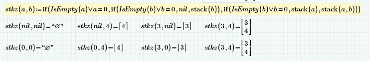

Having had a further look at my code, I suspect that the source of the problem is that IsEmpty tests for equality with nil, which just happens to be a single character.  I'm guessing that this is the source of the conditional problem  - I can't see how generic conditionals are going to create problems, but where there's a will there's a way.
I've poked around with my worksheet, replacing nil with some arbitrarily large negative integer (but one acceptable to the numeric processor), plus making a few other minor tweaks (eg, changing my IsPrime to prime?).  I've added in some symbolic evaluations at appropriate points.

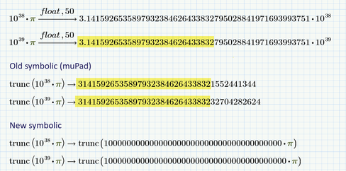

EDIT : The reason my routine does not work for higher numbers seems to be the symbolic evaluation of the "trunc" command as seen in the picture below. The new symbolic in Prime doesn't even know the trunc command.

As I have written above, all numbers for "s" above 28 yield no usable results, because the symbolic evaluation of the "trunc" command yield wrongs results. So unfortunately it does not make sense to let the loop run up to 100000.
This was the reason the program I posted in my first answer did not find the 38-digit prime. With Stuarts program it was able to find that number.
The next prime number (I am only speaking of the digits of pi beginning with 314...) as can be seen in Stuarts post will have 16208 digits. According to the speed measure I did so far and depending on the model we chose for prediction, Stuarts routine wold take 5 days up to a couple of years and its not sure at all if his program with Mathcads symbolic would be able to find and display that large number.
