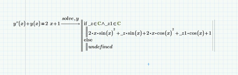

Playing with MP 9
Trying out MP 9 by solving a diff equation symbolical and got this ambiguous result- but it evaluate correctly:
Owe
cnegruAnswer

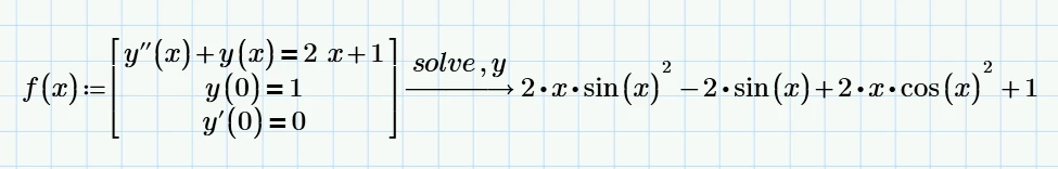

March 14, 2023
The result that you are looking at is the general solution. Place the equation and the boundary conditions in a vector to find a particular solution.
Cosmin

March 9, 2023
Why not simply
1 + 2*x + _z*sin(x) + _z1*cos(x)
ttokoro

cnegru12-AmethystAnswer
March 14, 2023
Cosmin
PREVIEW
