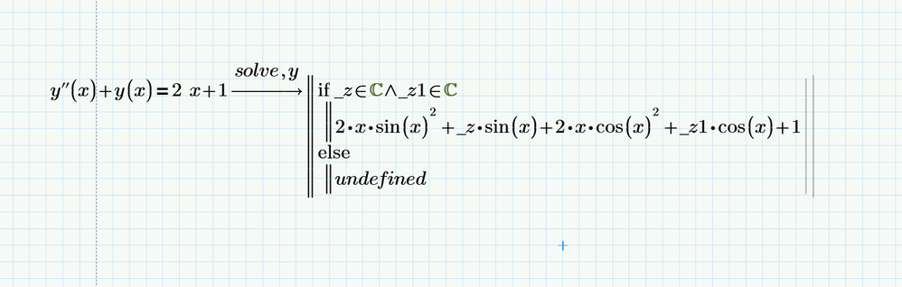

Trying out MP 9 by solving a diff equation symbolical and got this ambiguous result- but it evaluate correctly:

The result that you are looking at is the general solution. Place the equation and the boundary conditions in a vector to find a particular solution.

Why not simply
1 + 2*x + _z*sin(x) + _z1*cos(x)
