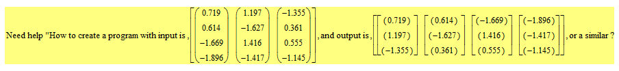

@Werner_E , if you don't mind, I still have another related query about "create a program". Otherwise, I'll start a new Topic.
Thanks again.
Best Regards.
lvl107
20-Turquoise
(To:lvl107)
Oh! no, Werner. I'm so sorry. You already helped me about that :
Thanks Again.
Best Regards.
