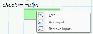

I am trying to utilize the new advanced controls textbox functionality by changing the background color of the textbox based on the input condition.
The input condition would be a defined variable called "Ratio" and whether or not it is above or below 1.
The textbox would be assigned to the variable "Check", if Ratio is above 1 than check would read "No Good" with a red background, If Ratio is above 1 than check would read "OK" with a green background.

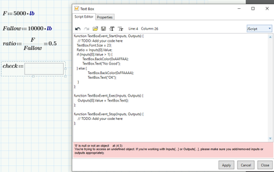

I have been searching through previous posts and had some help but am getting stuck with what appears to be passing in input variable "Ratio". I keep getting the following error.
I have put the file I am working on below for reference.

Hi Werner_E,
Yes I have used that reference you posted. it was very helpful. My issue was adding the input variable when right clicking the textbox box. I should have added my variable this way instead of trying to pass it in within the script. I than can collapse the input variables so only what I want to see is shown.
