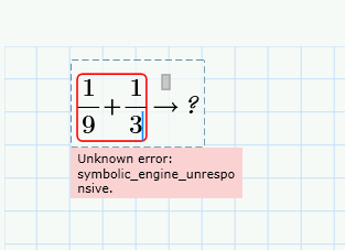

I am suffering a similar (though much more repeatable issue).
When we as a company upgraded to Prime I was the only one that could not use the symbolic engine & when I raised the issue it was fixed within 2 weeks.
Since then I have had a laptop upgrade & it has reappeared.
a repeat of the IT ticket has not resolved the issue.
Even the simplest task causes the symbolic engine to crash:
is the final response after many minutes of the sunflower twirling.

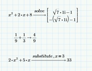

Sheet is attached, but probably not helpful as I can give it to colleagues who don't get the same problem. For them it quickly returns the expected 4/9result.

As you already suspected the sheet you posted works OK on my side and probably for most of us.
So the problem which you experience seems to be specific to your installation

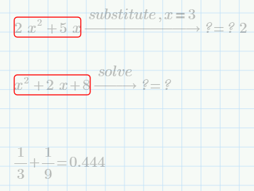

I do not understand why below shown expressions are displayed in grey color.

I assume that the 2nd & 3rd lines are grey because the calculation was stopped & these were left 'pending'.

I think that grey expressions are corrupted somehow and you have to delete them and type again.
Greyed out regions means that they were disabled. In real Mathcad this was indicated by a small black square in the upper right corner of the region.
You can re-enable a disabled region either via the menu or the right click context menu:

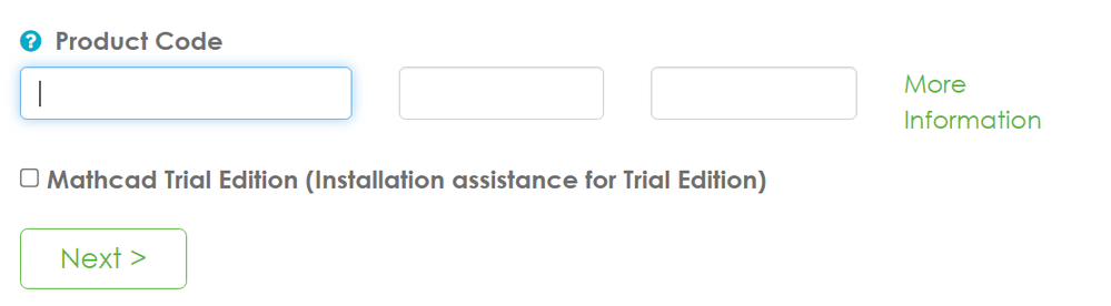

open case at PTC Support and ask them to resolve the problem.
Martin Hanák
Yes I will try Thanks. First I need to find the product code.
All I see is a service contract number in the installation under the license. Can I get further using that?
Andy
please see uploaded video.
Martin Hanák
Hi Martin
When I follow the instructions in the video I only end up at a page where I only have the choice Mathcad and when I click that I have to enter a product code. Seems like things might have changed.
