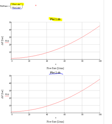

Thank you @Werner_E  and @LucMeekes !
Quick follow-up regarding plots:
Is it possible to link the plot title to e.g. a vector containing the name of the files?
So when I enter a new list of excel filenames, the plot titles would automatically update
Regards
Siggi
LucMeekes
(To:snã¦ss)
Quick answer: No.
The plot title is not a variable accessible from within mathcad. It, like the rest of the plot, can only be entered through the user interface.
What you can do is, if the file name is a (string) variable, evaluate that variable above or on top of the plot.
(To:snã¦ss)
As Luc already wrote you can't control those settings via worksheet variables.
An alternative to placing regions with evaluated variables to show filenames alongside the plot is, to place scripted textboxes above the plots. You have control over font size, color etc. that way.
When you open the attached worksheet you have to click "No" to allow the script to run.
