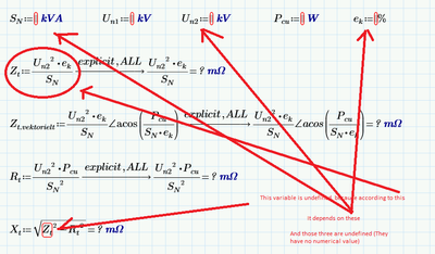

Hi!
I am experiencing an error that states: This variable is undefined, even though it is.
What is the problem here?
I am running Prime 8.
/Frederik

I've been caught on this one before.  First on the Calculation Tab under Calculation Options, activate "Units/Constants in Symbolics".  Then in the same tab, hit Calculate.
I have made that change to your document and entered some dummy values.  It works now.

Wow, thanks for a quick answer. It did solve SOME problem. But now a new one occurs.. "This value must be real"
Thats what it ways when I input data to the variables.
Please see the attached screenshot, its from page 2/7 in the worksheet.
I hope you can figure it out, i believe in you!
/Frederik

The problem is the acos() expression you use. With the values provided, the argument is greater than 1 (1.15) and so the angle is non-real. You have to provide a real angel, hence the error.
Use -> before =.

Hi Luc. I know how to input data to my variables, however this is not my problem. When I fill in data, it still gives me an error.

I noticed the missing variables too.  When I entered dummy values, I had the problem that Fredrick referenced.  That is why my response about Units/Constants in Symbolics.  That is what ultimately solved the problem.
