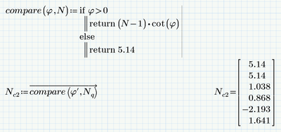

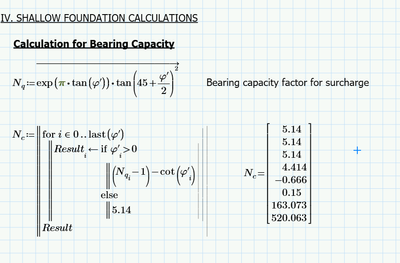

I need help with using if statements with matrices. I don't think masking will help here since the code should be able to determine if the friction angle is 0 or not.
If anyone could help find a solution, I'd really appreciate it. This is my 3rd week of using mathcad - currently trying to transfer all our company's geotechnical excel worksheets to mathcad.
(To:CF_10130026)
One would expect that if you vectorize the expression you created it should work as expected. But unfortunately Prime does not allow to vectorize a comparison operator like ">".
One possible way out is to write a program which cycles through all the vector elements using a for-loop and creates the desired vector of values:

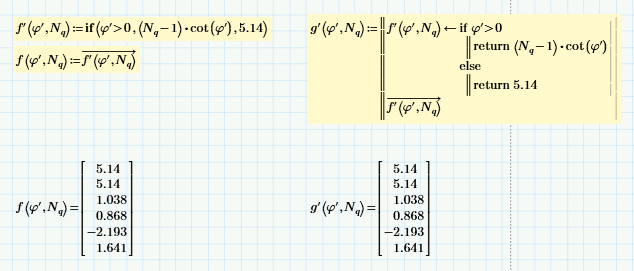

Another way is to write a utility program which does the comparison and then call this program vectorized (which is something which Prime would allow ;-):

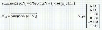

Of course you could also use the if-function instead of the if-statement. It may be less clear but is more compact and also works in Express:
The screenshot you try to duplicate does not state what should happen if the angle is negative!
I followed your attempt which treats negative values like zeros.

One could also make the comparison function a local function ...
I think Prime will allow vectorization of the comparison operators; it's "if" that it doesn't like (for the baffling reason that "if" is a ""pseudo function").
Stuart
